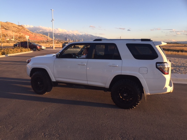

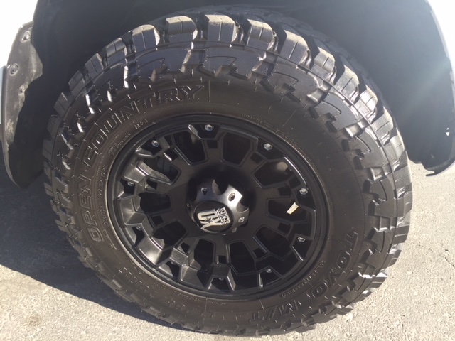

Alright folks... quick question... I just picked this 16 4runner trail up yesterday for my wife (after some bonehead on a cell phone totaled her 15 trail).
It came with 265/70r17 toyo open country MTs... mounted on KMC XD800 Misfit wheels.... yeah, I usually think the XD wheels are retarded, but for once, I think these actually look pretty good.
Problem though... the wheels are 17"x9" with 0 offset (5" BS) according to the specs on their website. The Toyo tires have a wheel width range of 7.0"-8.5". I'm clearly over that...
I bought the car this way... is it unsafe? Should I be looking for different wheels for these tires? They rub slightly on the fender liner, but I haven't moved the liner forward yet. I want to stick with the 265/70r17s and the aggressive look, but do not want the tires sticking out of the stock fender flares tearing up my paint and throwing rocks and salt on the side of the car. What is a good wheel width/BS/offset for getting these tires flush or slightly inside the wheel well without rubbing? It has a small 1" spacer lift in front now, I plan for more lift, but won't be exceeding 2"

Something else to keep in mind. Those wheels don't use OEM lug nuts, they use a tuner style lug. Make sure the "key" in in the truck somewhere otherwise if you get a flat you can't remove the wheel. Also, check the spare tire. If it's a stock spare, you will need to keep 6 factory style lug nuts with you. In the event you ever get a flat, you can't use the spare tire with the tuner style lugs. You have to use OEM lugs with the spare tire. I have the same type lug nuts on my truck. I used one of the cloth bags my Crown Royal comes in to keep the 6 stock lugs in and the required tuner style lug key. Stuck it right in the 1/4 panel with the jack. The cloth bag keeps them secure and quiet in there.

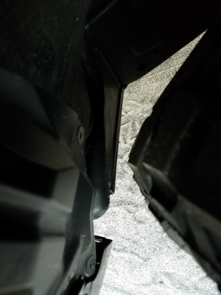

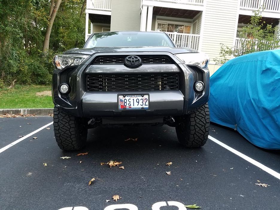

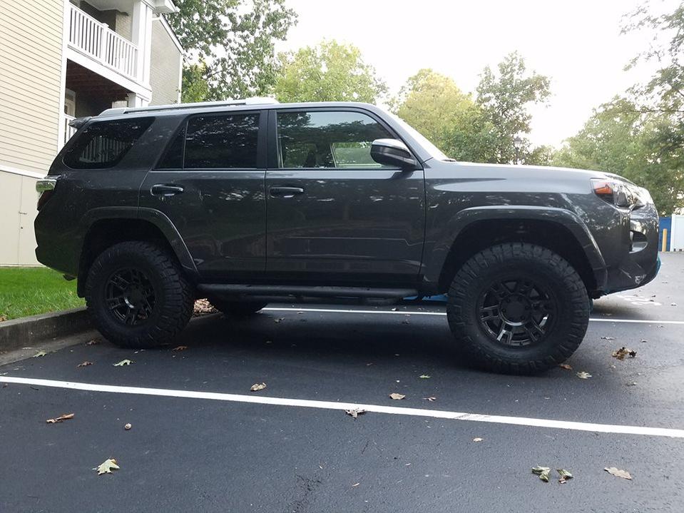

I have them and i'm happy with them. Only place to buy them is direct from FN Wheels as far as I know. I'm lifted 3" front, 3" rear, 295/70/17 Ridge Grapplers, no BMC, just unbolted the lower front fender liner from the bottom side of the bumper, moved it forward, bolted it back in, and trimmed a little plastic. Back has a slight squat due to having a set of 4 285/70/17 KO2's back there and I was parked on a slight downhill.
