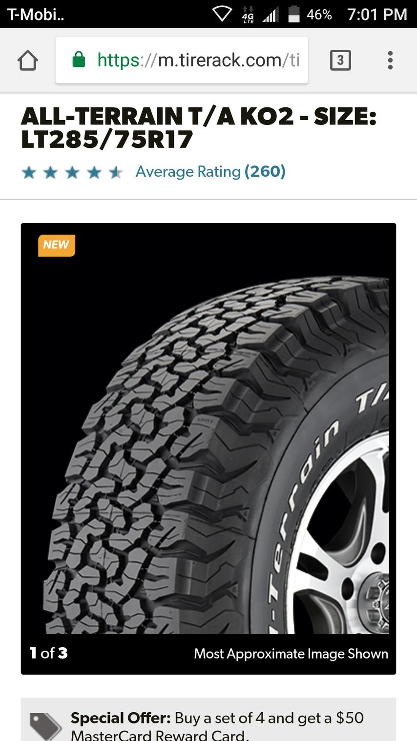

New BFG KO2 size
New 285/75R17 in KO2s
Maybe they will finally release KM3s....

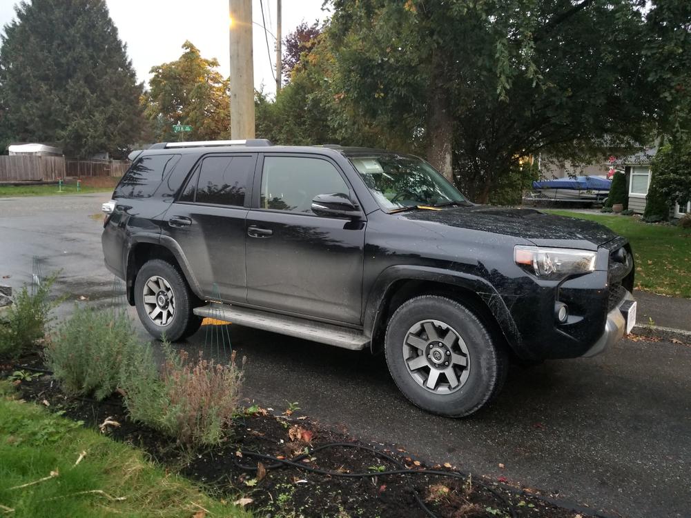

Hi All
Does anyone know the wheel specs for a 2017 4runner TRD Offroad
I want to know if I can fit 285, 70, 17's
Thanks
Adrian
You can however you will likely need a wheel spacer and will absolutely need a lift.
Not necessarily. You can run 285s on a stock suspension with a fender liner mod if you drop the front mudflaps and keep it on road. Did it for 6 months before I installed my lift. Rubbing in reverse at full lock on the body mount. A bmc could get you by without a lift.
I did it also. No rubbing on the BM, only the front fender liner at lock in reverse. It all depends on what tire you run. I ran a KO2 which runs on the smaller side of the 285 range and I had a 17x8 wheel with 4.5" BS and 0 offset. I can tell you a 285 Ridge Grappler is quite a bit bigger than a 285 KO2 and would have rubber much worse. Anything can be done with enough trimming.
