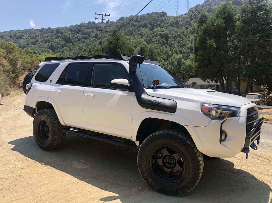

Just wanted to share my set up for people to reference I have icon stage 2 at 3” with 285/70/17 KO2s on method NVs and have Zero rubbing at all, I took the front mud flaps off and used the heat gun fender well trick before I installed everything but have no issues and no need for a BMC which is a nice feeling!

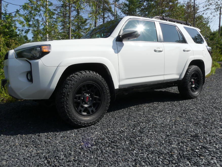

FWIW, I just mounted some cooper ST MAXX in 255/75/17 on TRD PRO wheels and am experiencing no rub on an otherwise stock '15 Trail premium w/kdss. I love the look and ride and the tires get decent reviews. Thanks OP for the chart and everyone else who contributes to the thread to give me ideas on what I can run without chopping. Someday I may even post a pic!

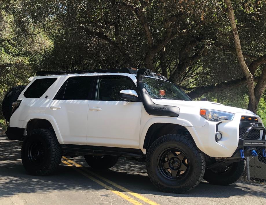

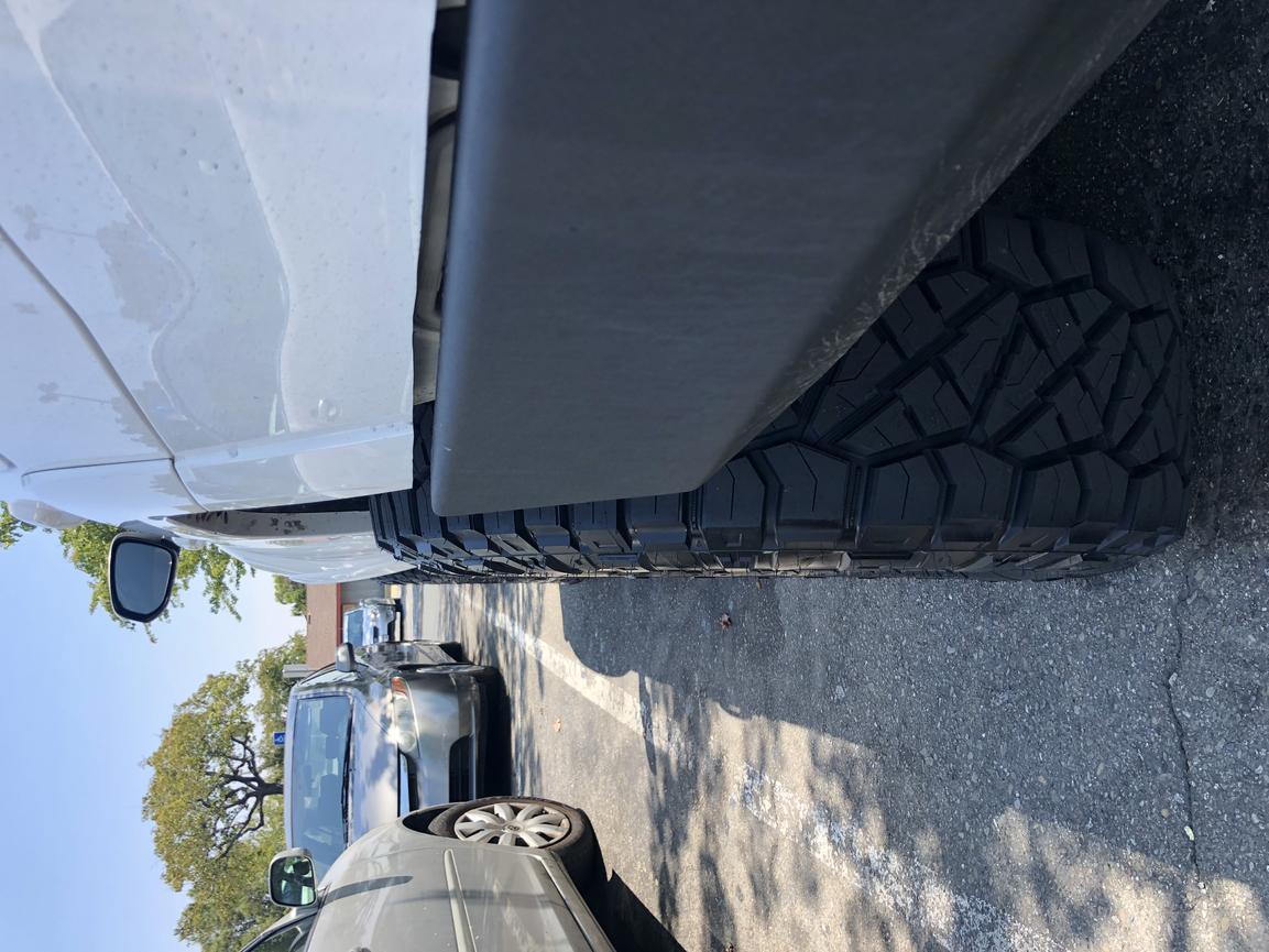

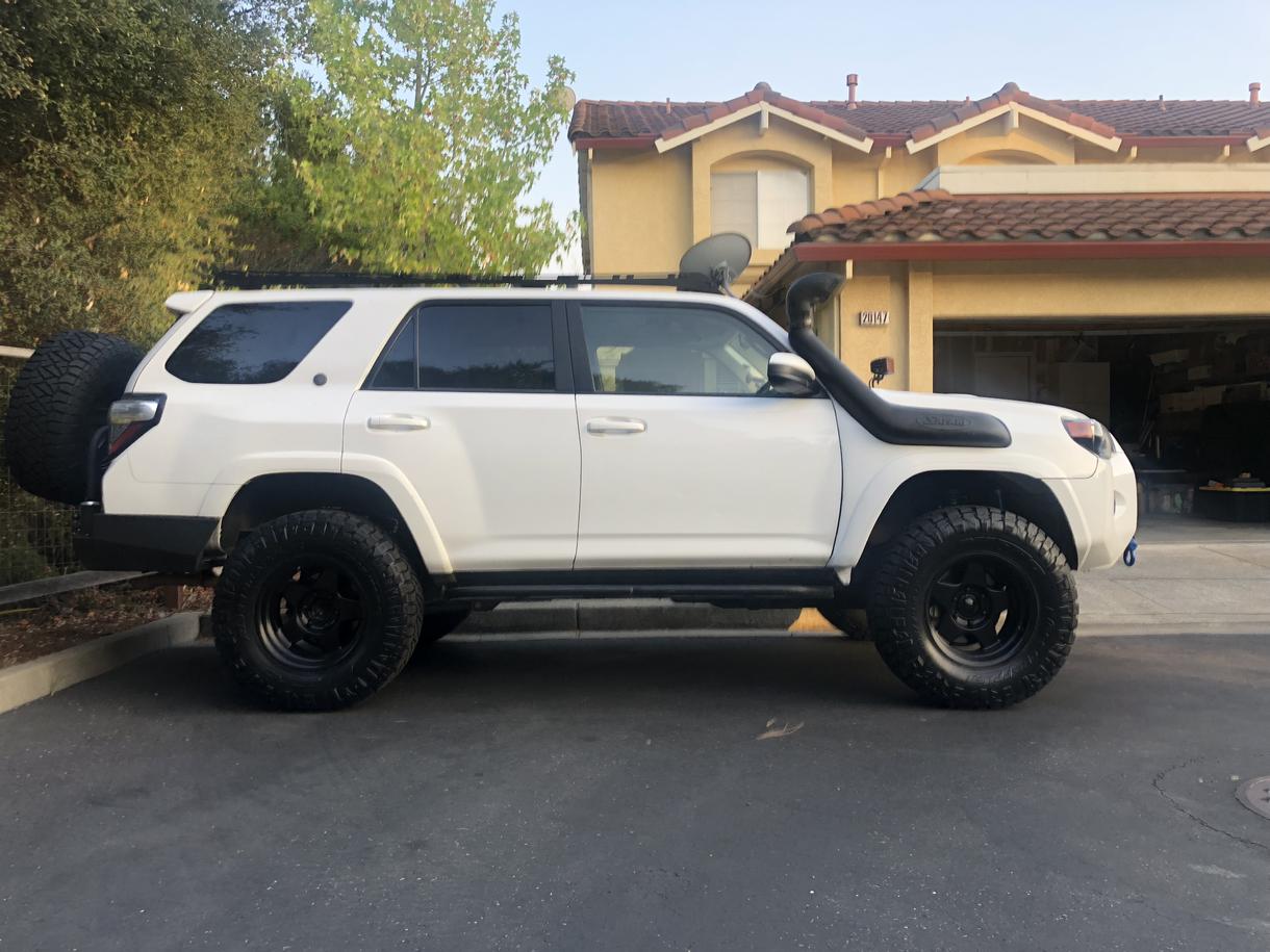

I used to run 285/7017 but I went big this weekend and moved to Nitto Ridge Grapplers 305/70/17 w/ SCS F5s 17x9. My setup is:
King Adjustable Coils Front
Total Chaos UCAs
Icon 3" Springs in Rear
King Adjustable Shocks in Rear
Timbren Bump Stops front and back
McQueen Wide Body Fenders front
I did a very aggressive BMC, removed the fender liner and modded all of the pinch welds as well as cut the front part of the bumper. I have no issues with rubbing as of now and will test it on the trails next weekend. I imagine there will be some rubbing.
Fills in the wheel well nicely and I love aggressive offset on the wheels.

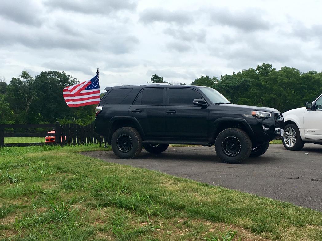

Took a few pics after a wash with the new 255/75/17 st maxx. Now that I wheeled with skinnies, that's all I'll ever purchase going forward. Good size for a stock setup IMO.

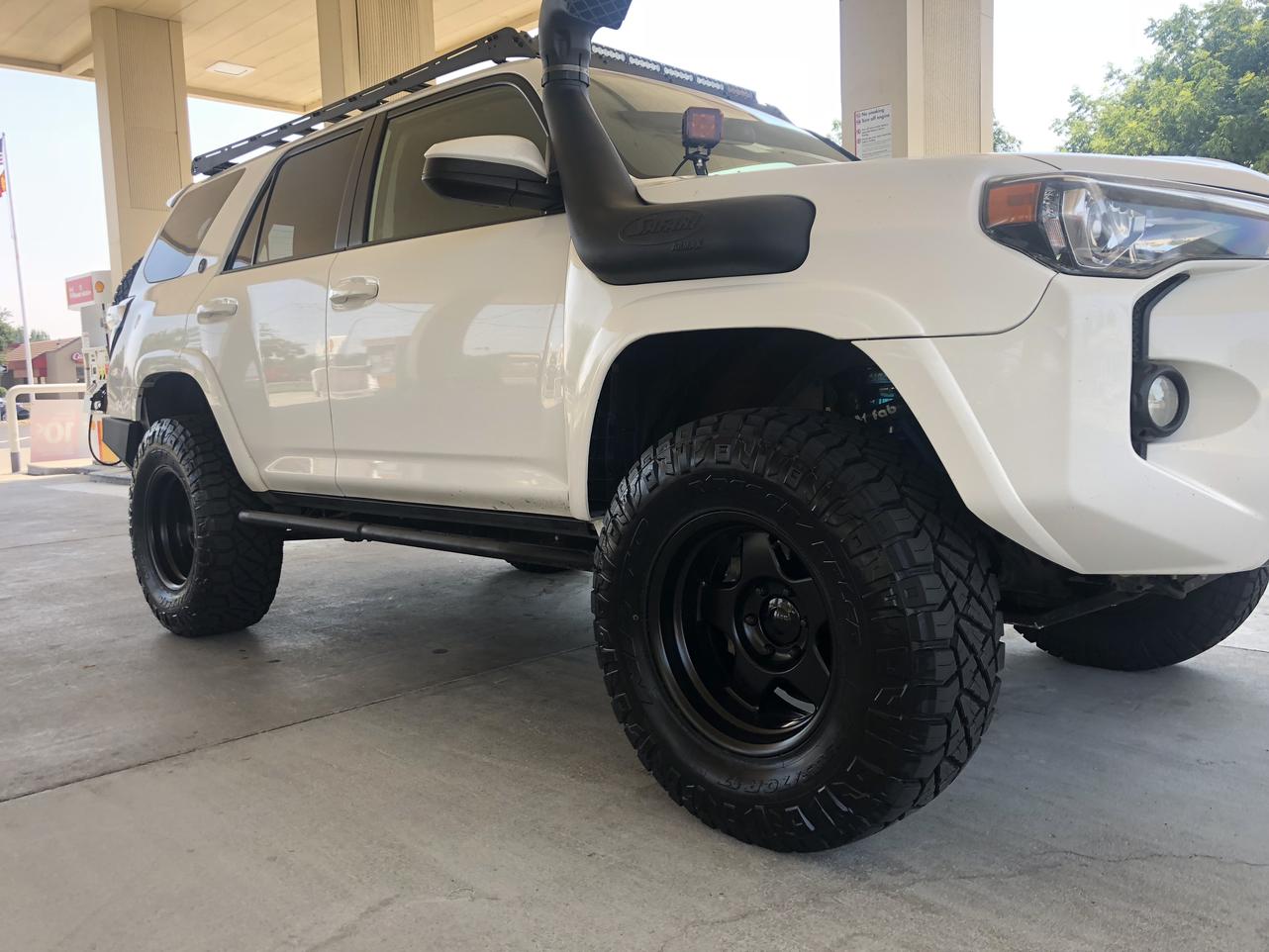

Total Chaos UCAs
sWEET RIG MAN LOVE THE STANCE AND MIX OF WHITE/BLACK, VERY CLEAN.

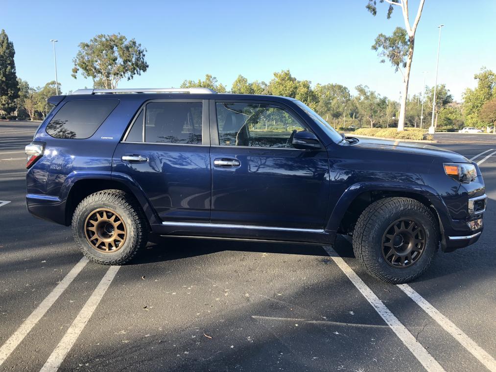

Same issue here: rubs only near full lock in reverse (and moreso when turning left than right). I didn’t expect to find these trucks so variable or assymetric.
My setup: 265/70-17 Pirelli Scorpion ATP on EvoCorse Dakar Zero 17x8 ET0. Stock height 2017 Limited. What looks green on the chart ended up rubbing.
Looks like I have some fender liner modding to do. The tires strike me as running large, but I haven’t measured.
YMMV, and probably will!
