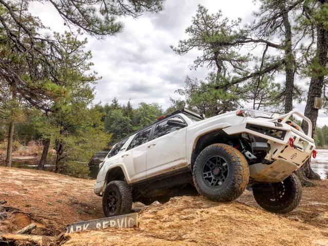

295/70/17 Ridge Grappler on stock pro wheels
No bmc
Cut the inside of my mud flaps
Full metal front bumber so no rubbing
JBA HD UCA's(most positive caster available)
Kings lift
