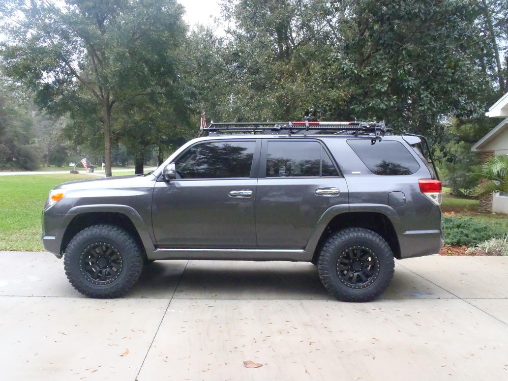

Lift and Gobi done. Thanks Roktoy.
looks good, which wheels did you end up going with? offset?
I did the 285/65/18, which is about a 32.6" tall tire. I think the duratracs are a 33" I kind of already wish I did a little bigger, maybe the 295/65/18 which are 33.1 and would have stuck out another .5"
