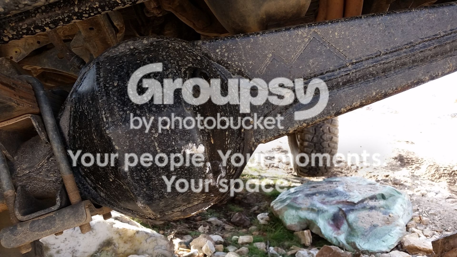

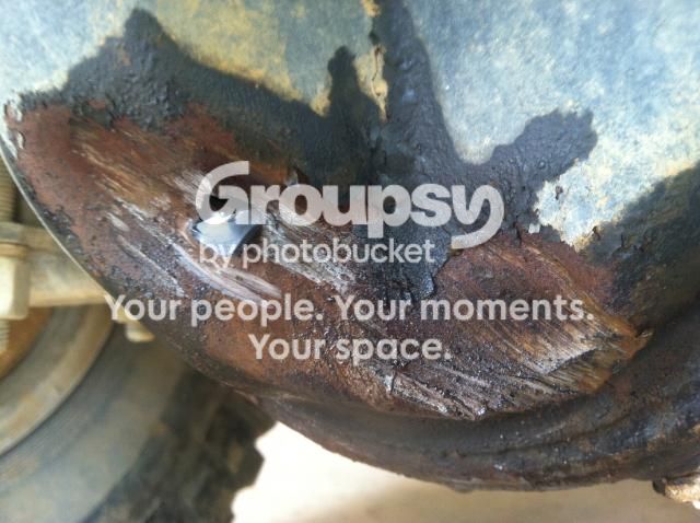

Barnes 4WD HD front diff cover (busted the OEM one at URE)

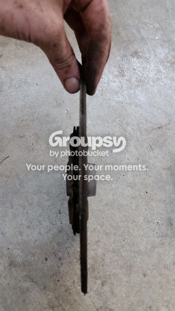

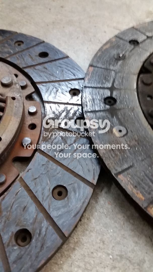

Burned the clutch at Potts Mountain.

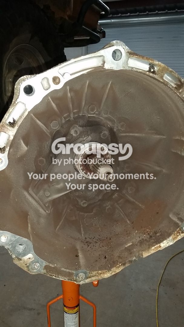

The transmission has been pulled out for about 2 months now but I have not had any spare cash to buy a new clutch. I got a better paying job a few weeks ago so I plan to have the truck back together by the end of the year.
