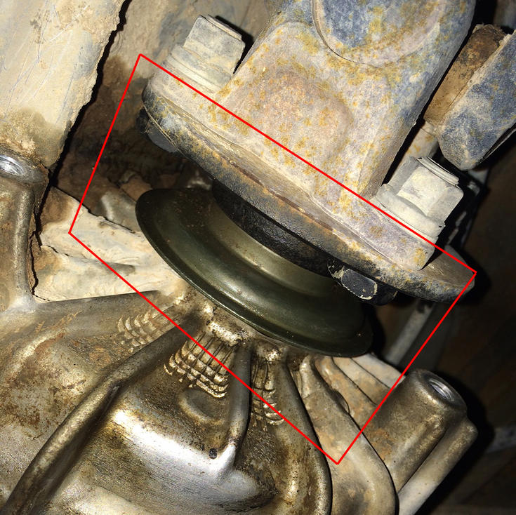

Found this and a few threads after seeing a small leak under the truck. I've attached a pic, doesn't seem like I'm having the actuator leak as that is all dry. Leak is coming from where front driveshaft bolts to transfer case. Any ideas?
Yup. There is a seal there that is leaking. I had mine fixed by the dealer for $125, but they covered half as I just bought the vehicle. I'm sure a local mechanic can do it for that price if you have one. Not too involved of a job.
Just talked to my local dealer and got quoted $150 so will get it taken care of next week.
