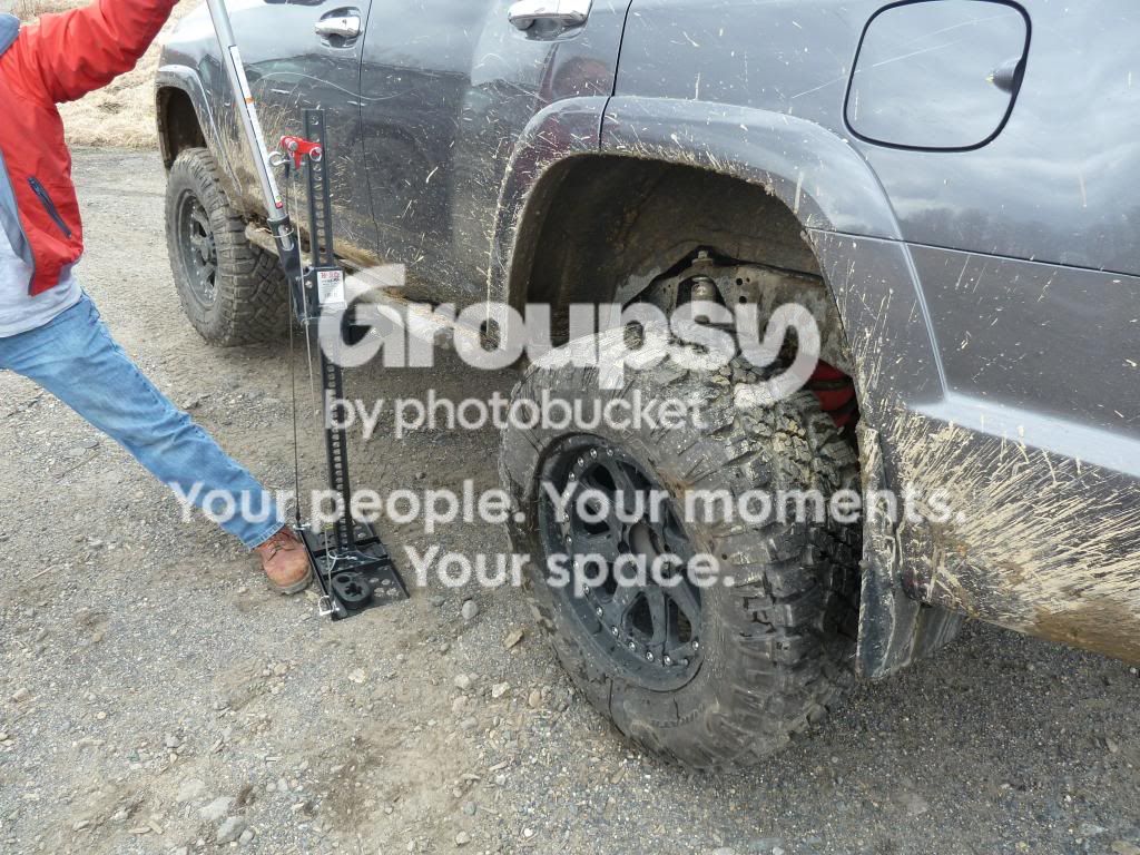

Hi-lift is no more complicated than a regular bottle jack:
stewart.swf
It's a bit easier if you have sliders... Bigger question is where you are going to be storing it on the vehicle and if she can comfortably and safely retrieve t from there (my wife will not be able to get if from the roof rack without some assistance.. she's a shorty-but-cutie).

I've used a Hi Lift to change a tire on the trail and it's fine as long as you know how to use the jack properly. That Safe Jack base looks good for improving the stability of the jack but does nothing to prevent "autojacking" which is where injury or death seems to occur most frequently.
