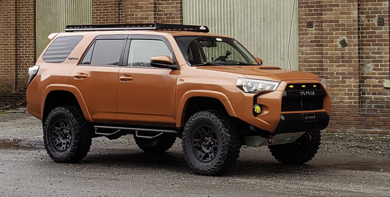

Got the SSO high clearance mod done today
stephan07

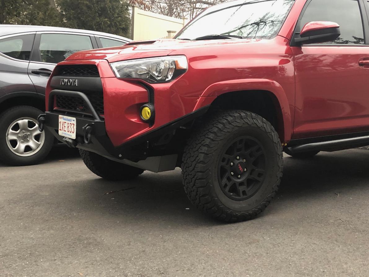

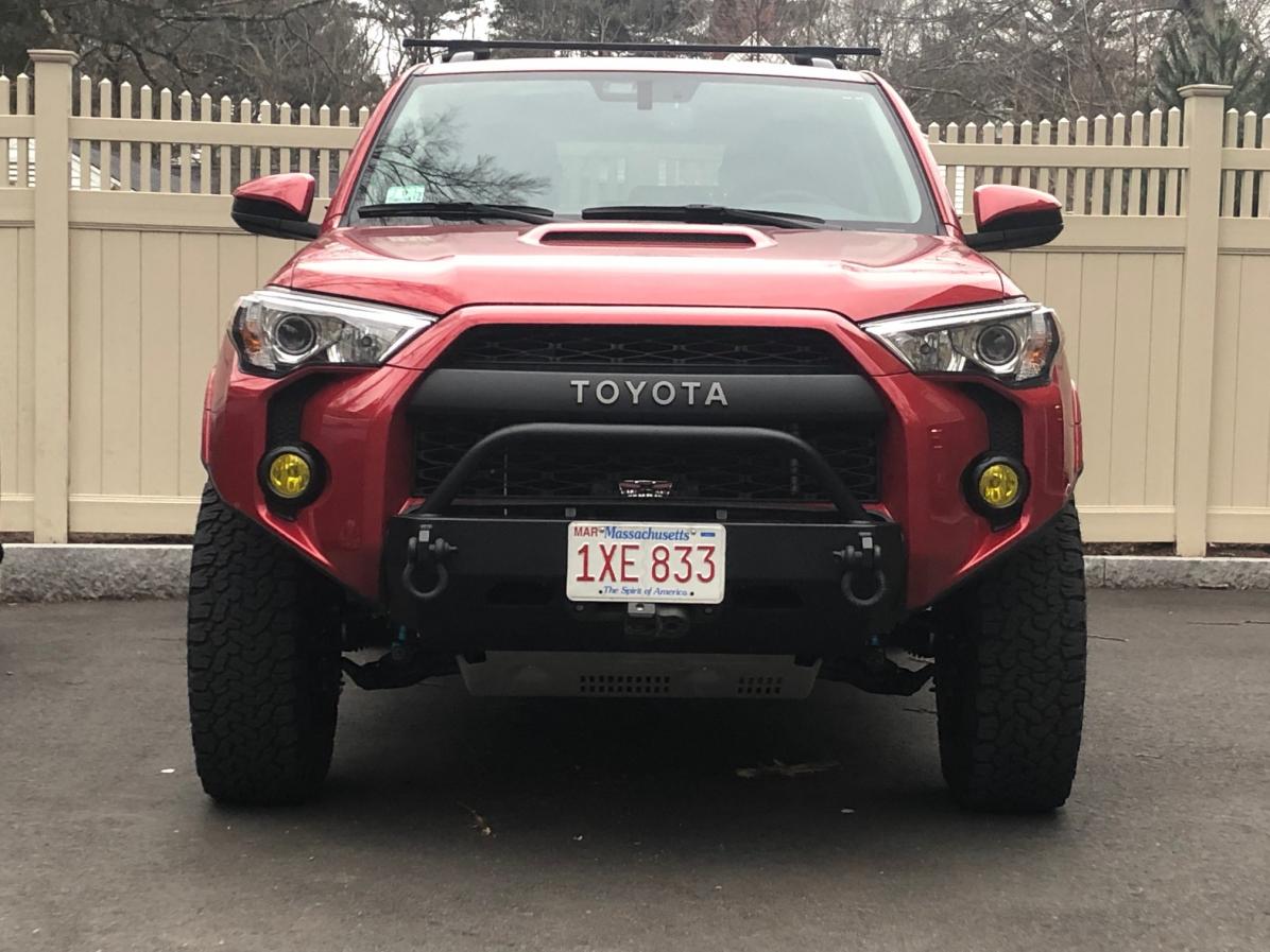

I ordered these back in early November and they showed up this week. Took about 90" to get them installed and 2 Sip of Sunshine brews. Not a perfect fit secondary to my trimming, but pretty close and looks great.
The new wheels and 285s go on this week along with stiffer springs for the King Coilovers.
I've also a Frontrunner rack in the garage if we get completely snowed in and I feel up to it tomorrow.

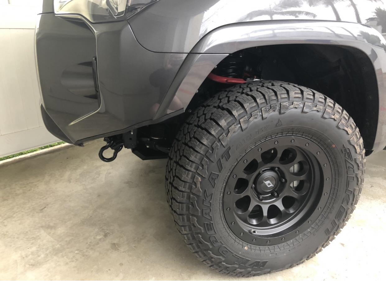

Looks kilker! I did mine with a dremel, and $10 in rubber weather strip :thumb3:

What didnt you like about your cut and how would you do it differently if you could?
Funny, after I completed the install, I was like why do I even need the added weight from SSO. Its built solid as hell, but its not like it really provides any side impact protection.
In terms of the cut...No instructions were included. I followed the vid from Wonderlust Overland. I would imagine that since these are all made to order there is a bit of variance. Add to that that they bolt on to the SSO slimline bumper, its no wonder there is variance.
I would cut the fenders larger than stated, try on the metal piece and and trim as needed. My two sides are no where near identical(prob only 1/16th off, but enough that you need to custom cut each side. That said, they still look very good. Once I have the 285s on I think they will fill out the wells nicely.
Again, as much as I hate to admit it!! Yellow snow is correct...just cut the fenders and use some weather stripping.

the instructions have to be downloaded from SSO's website. Its pretty detailed and came in handy during my installation, although looking back, it wasn't the easiest way to install the wings. I also studied the YouTube video from wanderlust but they skipped a few steps that I wished they had included.
I have no regrets with my purchase, i think its cleaner than just a bumper chop but then again, is it worth 300 bucks??? Thats up to the end user to decide.

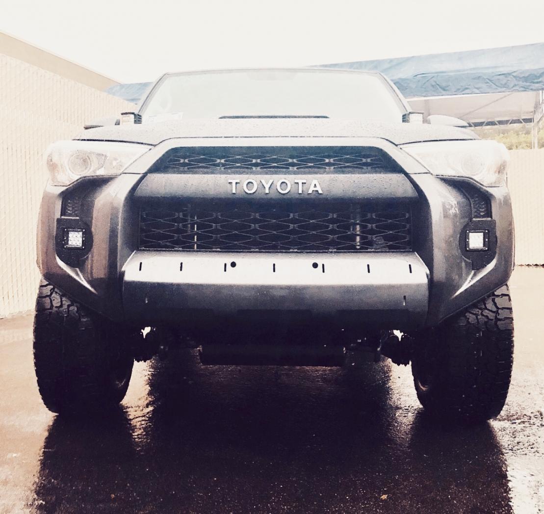

I went with the DIY route as well with my SSO. About 30 mins and a dremel!

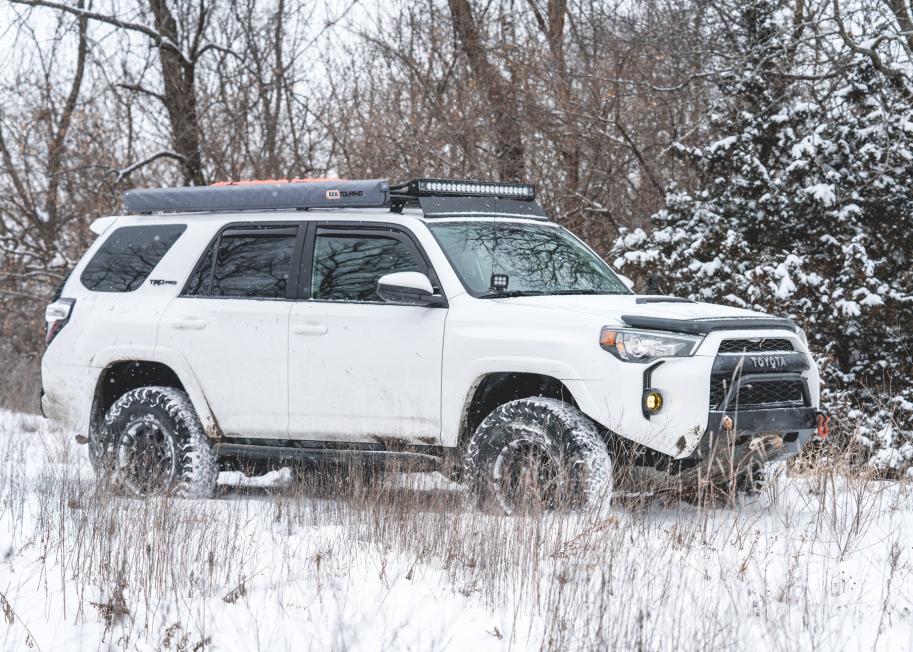

Sawzall with fine tooth blade and edge trim. The SSO kit is nice, and adds a level of protection, but to me, it takes the cut too high.

I struggle with this MOD. I absolutely love how it makes the truck look from the front. It looks like it does exactly what it's designed for; making more clearance for crawling up onto larger, taller obstacles. Then I see the side view and I cringe. I think a more contoured cut, leveling out more on the side so it doesn't end up so high, would be perfect.
I actually did that first, and wish I had taken a picture. It looked like hell.

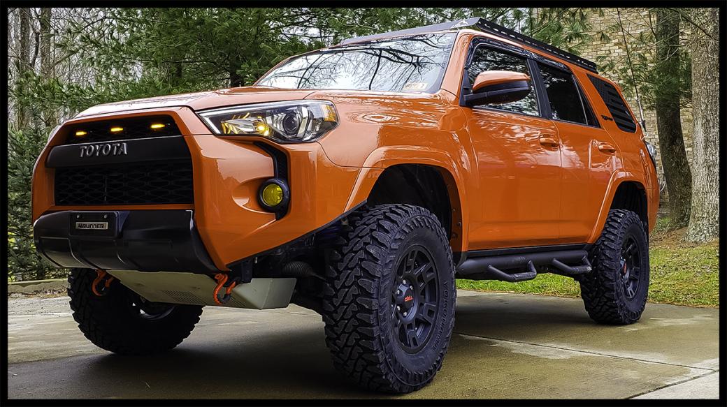

i did a quick photoshop of the side profile with it a bit more contoured. I did more of a straight across cut. If I had contoured it a bit more, it might not have been too bad.
