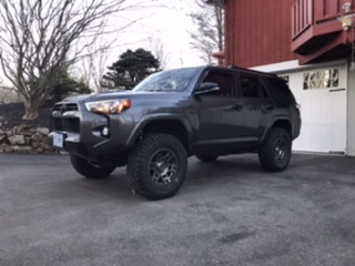

Got the SSO high clearance mod done today

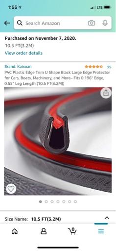

What is everyone utilizing for the plastic or rubber edge trim?
I used these from Amazon

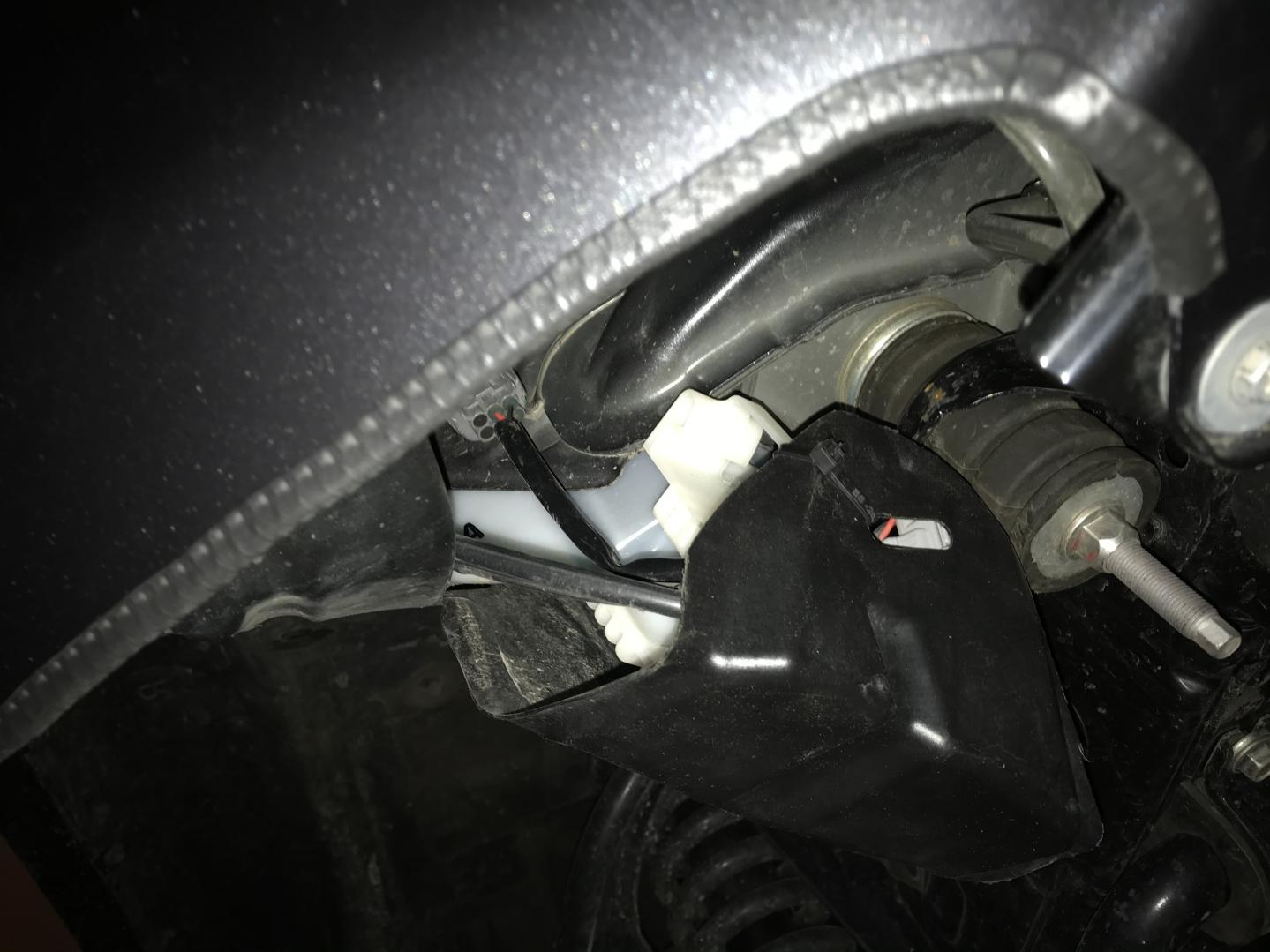

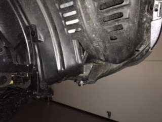

One thing I want to point out is that I figured out a good way to attach the passenger side inner fender in a way that mostly covers the washer bottle, while also leaving almost all of the liner intact.
I cut the liner vertically just outside of the washer bottle, wrapped the inner portion around the bottle, trimmed just the end of that piece down a bit and zip tied the end of it to the plastic washer fluid hose retainer on the front of the bottle. The outer part I zip tied to the fog light bucket, after drilling a small hole in the bucket.

With this particular cut, which I mentioned before is like the middle-of-the-road option, the washer bottle is not overly exposed. I spray painted mine black at first, but I'm not in a hurry to do it again now that the paint is wearing off. It's just not that noticeable.
A heat gun will be helpful to manipulate the fender liner how you want. And zip ties are perfectly adequate for holding it in place if needed. I like using the zip ties, since they are easy to put on, they hold well, and if you need to cut them off to get in there it's no biggie to replace. Sounds like a hillbilly fix, but it's effective and easy, and nobody will notice.

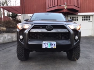

I cut mine according to your recommendation, and I really like the way it turned out! Thanks for your advice
Check out my last post to see my solution for the inner fender/washer bottle situation.

Well done, looks great! Glad I could be of some help. :thumb3:
The remnants of my fender liner are zip tied to my washer reservoir as well, but I cut too much to make a neat job of it like you did.
