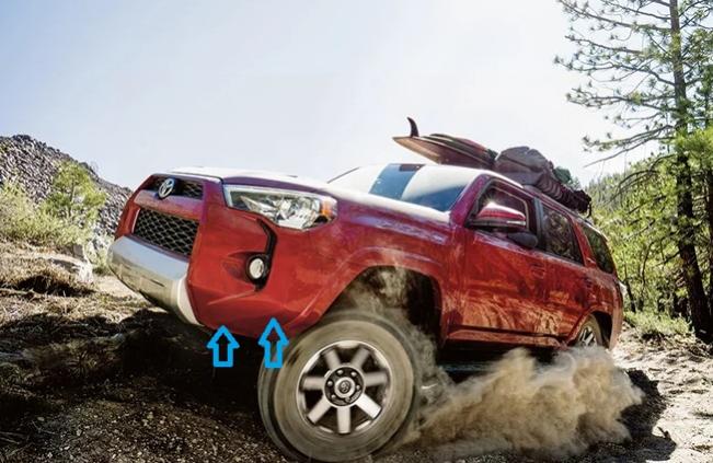

Got the SSO high clearance mod done today
This will most likely be my first MOD (My used TRD PRO came with a SSO bumper already). A few questions:
1) As someone who's never done body work would you recommend me install this myself?
2) Has anyone put any protective mesh in the exposed area to protect things like the fog light wiring?
3) My bumper isn't pre-drilled for the high-clearance kit. Is it easy to figure where to drill the extra hole into the Hybrid Bumper?
All of your trucks look great! Thanks for your time.
