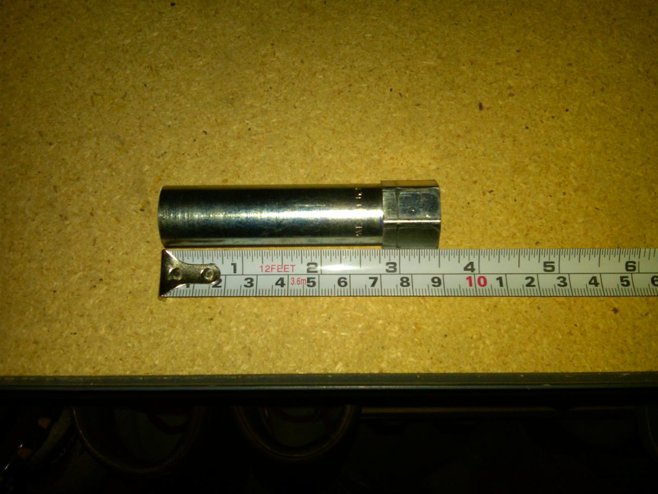

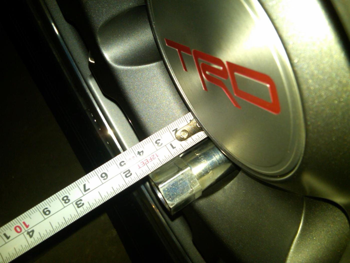

Ok, this is a little wierd. My spline socket (and lock socket) is 3.5" long and doesn't stick out of the wheel nearly that much when it's on the lugs. In fact, I think my lugs are much deeper in the wheels than yours appear to be in the picture.
The depth of the lug head from the outer edge of the lug hole (outside edge of rim) is ~2 3/8". The minimum depth is ~1 1/8" (from the lug head to the lug BCD circle -- i.e. the concave "U" shaped part of the rim).
With the spline socket on the lug, you can see the tool marks on the 13/16" hex head from where the original tech used the air ratchet to install the lugs -- the tool marks corresponed exactly to where the rim was damaged.
I'm going to remove one of the lugs tonight and get a measurement of the actual lug hole depth as well as the length of the spline lug. Either my rims (and now 2 sets that I've gotten from TRD) have deeper lug holes than yours or my TRD lug kit had shorter splined lug nuts (though the McGard website only shows one length of M12 splined lugs that I can find and they're the ones that TRD OEMs the lug kit from).
Looks like the bean counters got to TRD too! Guess I got lucky with an early set. Mine are 5".
I did not take the same measurements you posted, but estimate my lugs are 1.25 - 1.5" long (meaning that is how far they stick out after tightened). If yours are recessed way in there perhaps they are not as long.
Actually, you got the right kit with the long lugs and 5" tools... I called the guys at ToyotaTRDparts.com and the looked into the lug kit they sent me. I apparently got an early kit that had shorter lug nuts and tools (it did have the correct P/N on the package though). They sent me the correct, "extra long" kit for free --arrived yesterday and has the 5" tools and long lugs. Didn't measure them, but the lugs are definitely longer than the ones that are on the truck right now. Problem solved! Thanks for all the info and sorry for sorta hijacking the thread with damaged wheels rants!
Now I just need a set of Duratrac's installed so my rig looks as bad a$$ as yours!!!
