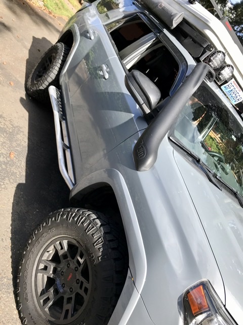

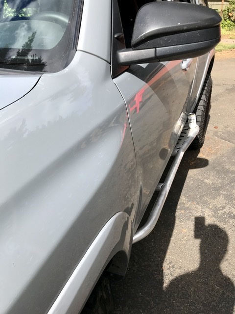

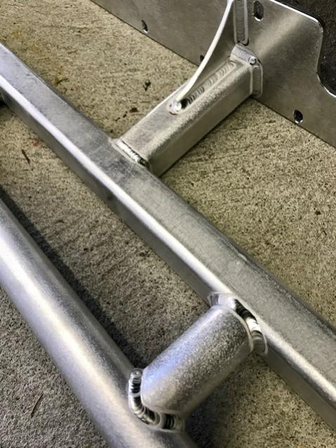

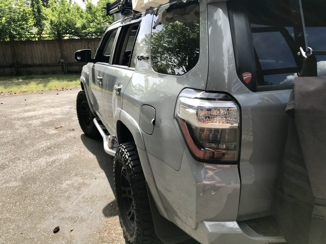

Took about a week from time of order, I opted to skip the powder coat.
Donovan the owner answered the phone and promptly returned emails. Super cool guy to deal with!
Quick shipping, great packaging, amazing quality (look at the welds and design) and super light weight. Didn’t weigh them but it might say on their site if I remember, around 25lbs. Great attention to detail, everything filed/grinded smooth. Perfect fit as far as holes lining up, etc. Zero issues with install. Took a cpl hours, with a floor jack it’s a one man job, all you need is a 12mm and 13mm socket/ratchet, 28 bolts, 14 per side.
I know in the last people wondered if you can use a high lift with them..... I say ya, they flexed a little but nothing happened. Might be different on the trail but at that point my priority would be to get home not worry about damage to my sliders. Just changing flats in anything not extreme? No problem.
Hope this helps anyone on the fence. Canadian exchange rate made them about $700. Support a small business.

Interesting. Considering sliders from Greenlane as well but w/ full top plate. In the description it says "but not designed to be used as a high lift jack point." Definitely not a deal breaker for me.
Yup. We drive on the beach a lot so we will see how salt effects it.
I looked at the website for Greenland. It looks like they are using 5052 grade aluminum. This is considered “Marine Grade”. It’s the same thing they make aluminum boats out of so you should have no issue with corrosion.
It’s not the highest strength aluminum but it’s probably the best grade for that application.
Those welds look very professional!

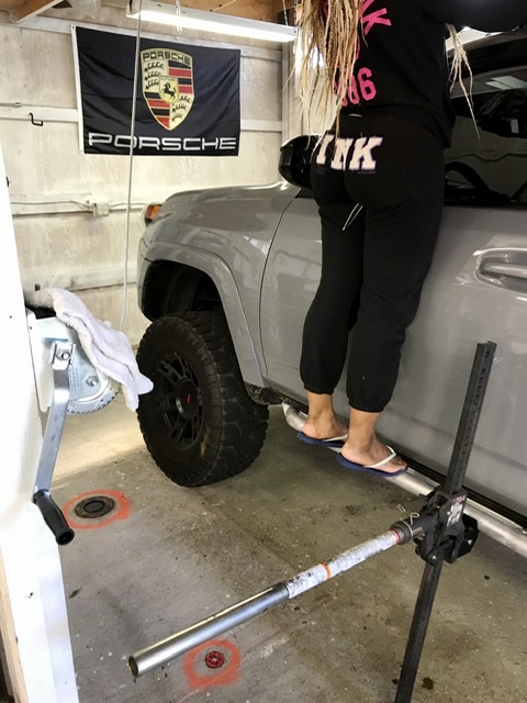

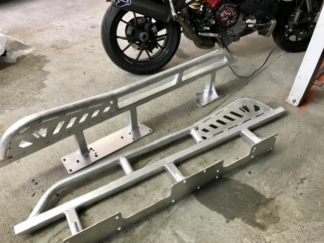

Cpl pics per request.

These are more then double the cost of my steel sliders. It's not like sliders are
really that heavy to begin with.
But, it's your money and rocker panels. Be sure to share when these push up into your doors. Love me some carnage.
So your steel sliders were $350? Good deal. I doubt I will ever really need/damage them but when I do, I will make sure to arouse and titillate you with some pictures.
I’m in Michigan we don’t have any rocks so no rock crawling all sand but I like the added protection to the body in the trails and parking lots. In Michigan they dump about a metric ton per mile of salt every day of the winter here so anything metal sucks and most sliders I see around have spots of rust in short time. So for me the added cost isn’t an issue to not have them look like crap in one winter. I’m going to have to look into these !!
