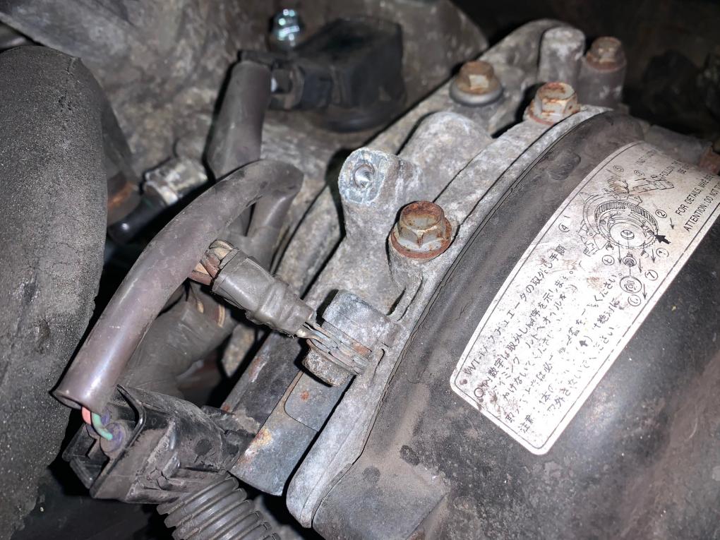

So this little ground wires bolt snapped in half and I can’t get it out and I figure I need to connect it somewhere so would this be a viable option or any recommendations for this?

As long it is to metal on the engine, anywhere that is convenient will work. Just clean the area well before hand with a wire brush. Use some dielectric grease to help keep it corrosion free. Or liquid electrical tape.
