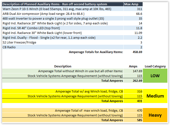

It's happening! Order placed for the 270-XP for my 2016 Trail Prem. Thanks to Anthony at DC Power Inc for his input on my planned electrical add-ons. The winch is the big hit but running it off a fully charged auxiliary battery at high RPM, with other items turned off, it shouldn't be an issue with the 270-XP.
For anyone curious, here's a photo of the planned mods and their respective amperage draws that will run off the dual battery and new alternator system. Should be in the low range 99.999% of the time.
