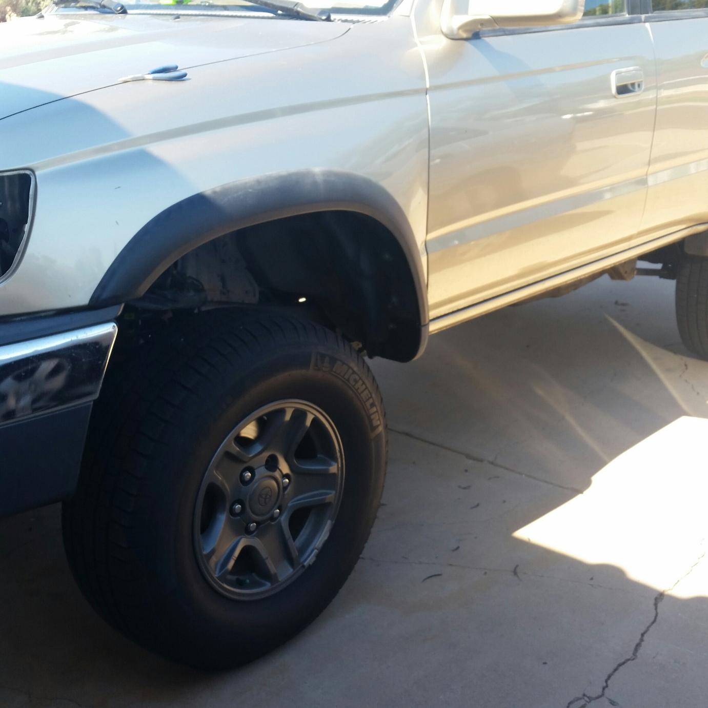

Here are the pictures as it sits now. I still need to do the following before I call it "done" -> Install a new passenger side sway bar end link (broke the other one while removing it, which turned out to not even be a necessary step), Install the 1" diff drop kit, shave the skid plate to accept the diff drop kit, install the extended rear brake line and bleed the brakes, and TRY to rotate the driver's side coil 90 degrees so it will (hopefully) not hit the coil at full droop.
Here it is, on the 3rd perch of Bilstein 5100's, Tundra TRD coils, with LC 8-wraps and Bilstein 5100's in the rear. The rear is sitting too high for my taste..and I REALLY hope it settles over the next couple of weeks / months (anyone have experience with this?). The tires are 265/75/16's for reference (basically 31's).
Thoughts?
Holy Rake Batman!!

this is mine on the third perch, it rode like crap, but here it is. considering a stock 4runner front sits at 19.5" hub to fender i was at 25" before my bumper and about 24.5 with it.

Looks just like mine did with the 7.5/8 wraps, like a stinkbug. I ditched the LC coils and bought a set of OME 891 instead.
I'm curious to this as well, I see others with similar setup that Dont have such a large rake. If this is what mines will look like I guess I'm gonna have to pick up a set of ome's for the rear.
