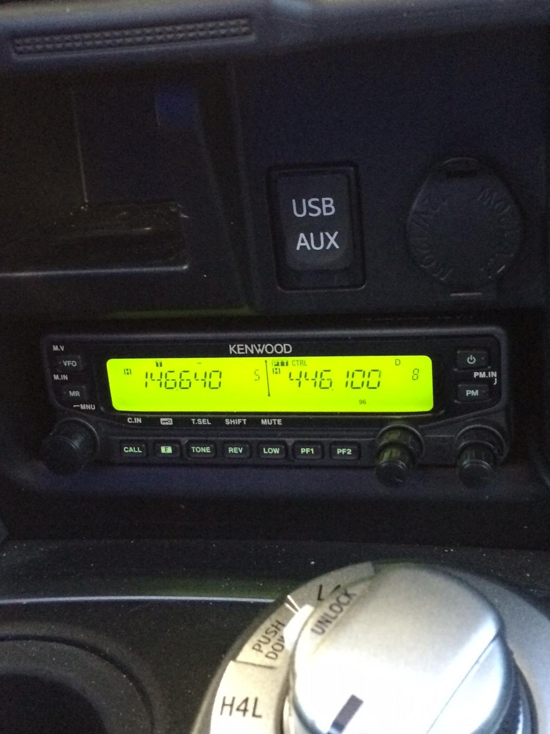

Remember that the antenna is an important part of the equation, and you will have to balance getting it up high with getting under obstacles. I keep short antennas for everyday use (and to get into my garage), and carry a 38 inch antenna stored in the truck in a PVC pipe for the days when I need distance. I say 38 inch, because that still allows it to fit nicely in the cargo area.
