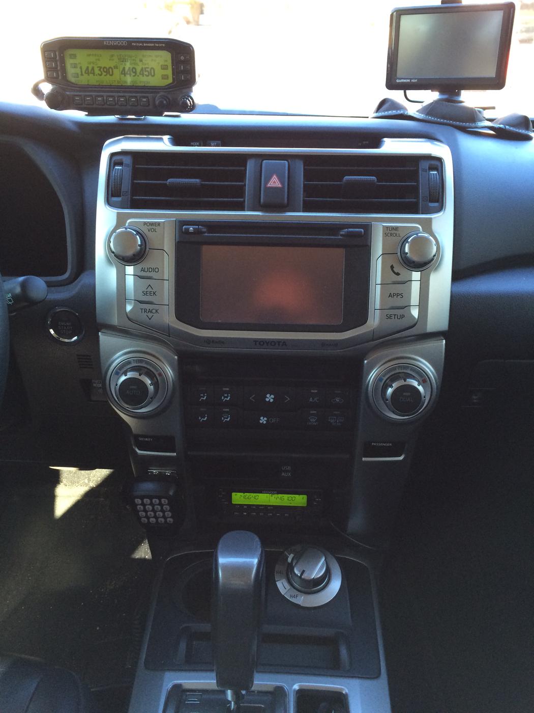

D710A and V71A in 4runner
DannyLlama, I also use the APRS to keep the spouse happy. Just make sure she understands that a stale position does not mean trouble. If you look at aprs.fi, you should be able to see where the aprs digipeaters (look for the green six pointed stars) are located in your area. Although you can get into a lot of dead spots,I've been pleasantly surprised at the coverage, a lot of them are placed on the fringes of the parks.
Since I had a hard time finding examples of installs in 5th gens, I will put some nice pics here. I've got the D710A faceplate mounted on the upper dash - personal preference- and the V71A faceplate mounted down low in the center cubby. For the D710A, the main body is under the driver's seat, with the faceplate cord tucked into the door jamb and run across the dash. V71A main body is under the passenger front seat with the cord run up through the center console. For both radios, I ran the antenna cable under the trim to the rear, up the pillar and out through the tailgate grommets to lip mounts on the left and right hand sides of the tailgate.

Thanks for the info! Do you need both D710A and V71A in order for the APRS to work? Or is there another reason you have 2 units?
Thanks!
If you wanna run APRS, you'll want a dedicated radio for it and another for talking on. I used to run APRS on a Kenwood TH-D7a with a portable Garmin e-Trex, would just throw that in the back somewhere and let it do its thing. You can do APRS a lot cheaper nowadays with these cheaper radios that have a tnc embedded in the radio, or just find a used D7a on Ebay!
