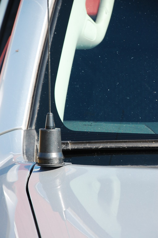

I don't know how APRS antenna needs differ from normal 2 way radio needs (?) so this may not be applicable, but I use NMO trunk lip mounts over the hood. Easy to route the coax, and simple to install. Not expensive either (Tram ones are like $19 with coax and PL259).

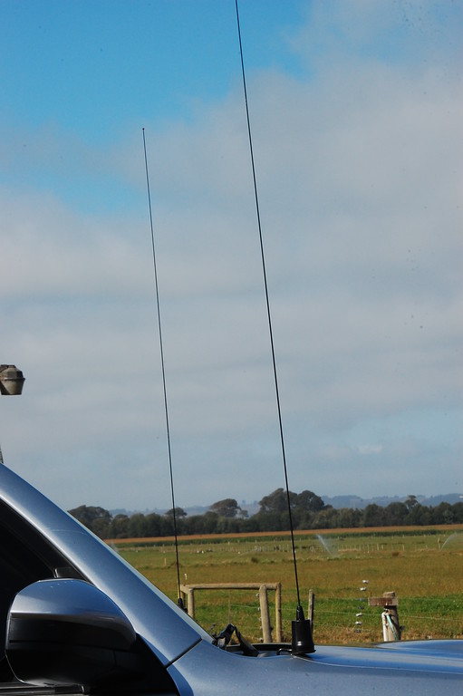

I installed the Icom 2730A with a RAM mount, Midland 21-406 speaker sandwiched on the rear passenger floor liner (shown in pic below with an electrical box cover placed on the bottom / carpet side of the rubber liner for stability), and Tram NMO antenna base w/ Avionics 5/8 wave VHF antenna on the hood. The Icom mic has a normal style mic hang up button with Motorola clip instead of the proprietary Icom clip.
