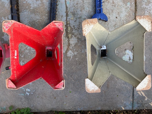

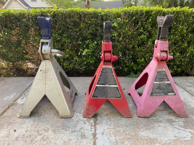

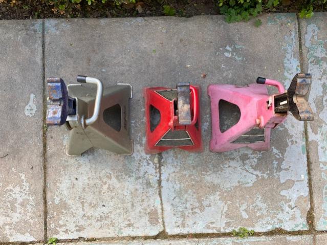

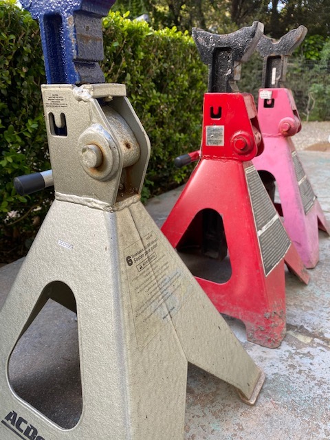

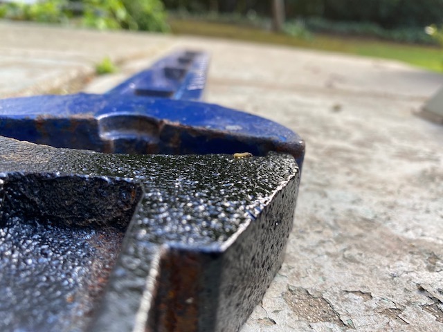

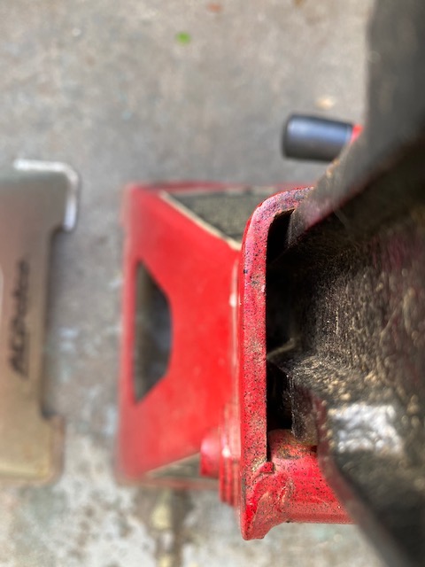

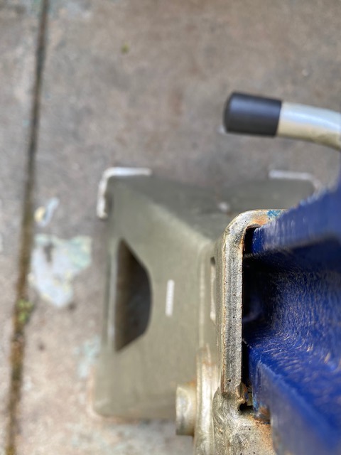

Edit: pulled out the 3x pair of 6-ton stands that I have on site. The bright red is the Torin Big Red, faded red is Powerbuilt brand. Sorry, no HF stands here.
The Torin and Powerbuilt are very similar, with an edge going to Powerbuilt due to the shape of the lift head. The Torin's have never actuated properly, they always require a rubber mallet to the engagement lever, and even then I don't fully trust them.
The AC Delco are my preferred of this bunch, heavier construction and smoother action. Notably, there is less play in the collar, ensuring the shank on the lift stays engaged with the stand. See the photos if that doesn't make sense (not sure of proper terminology here). Hope this helps.

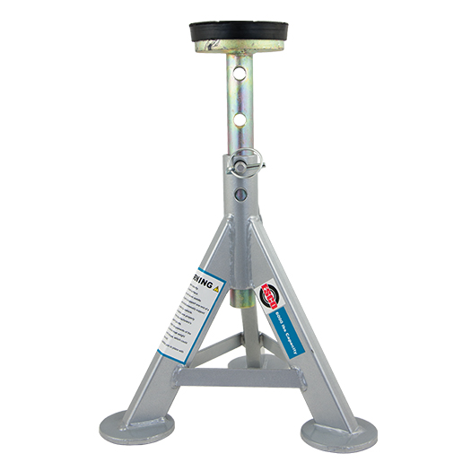

I use these, not as convenient as the slot lock type but much more safe in that regard.
Esco 3-ton performance
3 Ton Performance Jack Stand Kit – ESCO
Note: most jack stands rate tonnage by the pair, (Esco doesn’t) so most “6 ton” are actually 3 ton each.

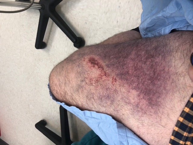

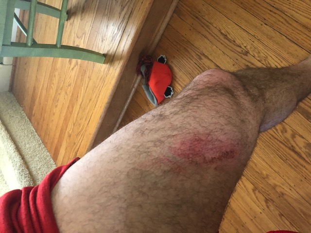

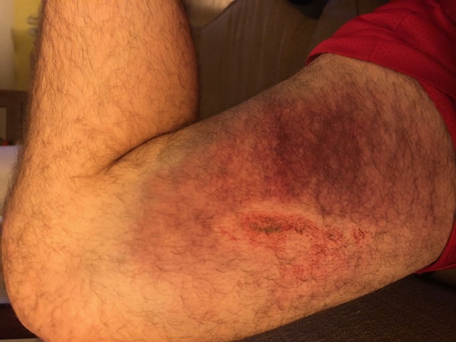

I had a HF one collapse on me. It completely failed, the weld busted and the entire stand collapsed. Truck fell on my leg, the rear disk landed on my thigh, and I reacted instantly and got my leg out.
1st Pic is immediately after
2nd is about 3-4 hours later
3rd is the next morning (12 hours)
4th is at the dr (2.5 days)
5th is 4 days - Front
6th is 4 days - back
This was April 2018
I still have an indentation in my leg from the rotor - just not as noticeable as the first year.
I wouldn’t trust a HF jack stand again.
