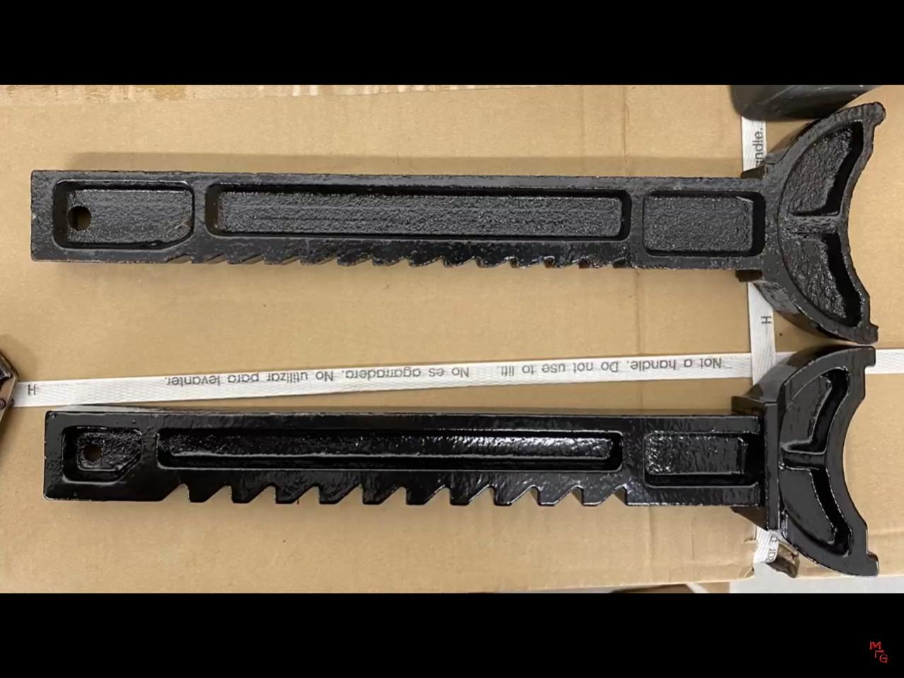

Just came across this YT video on the HF 3ton jack stands. Good explanation on the failure. Video is lengthy but you can skip to the meat and potatoes at 09:45
YouTube
Picture shows recalled version on top and revised on bottom
Good comparison, hard to believe they would make it like that.
