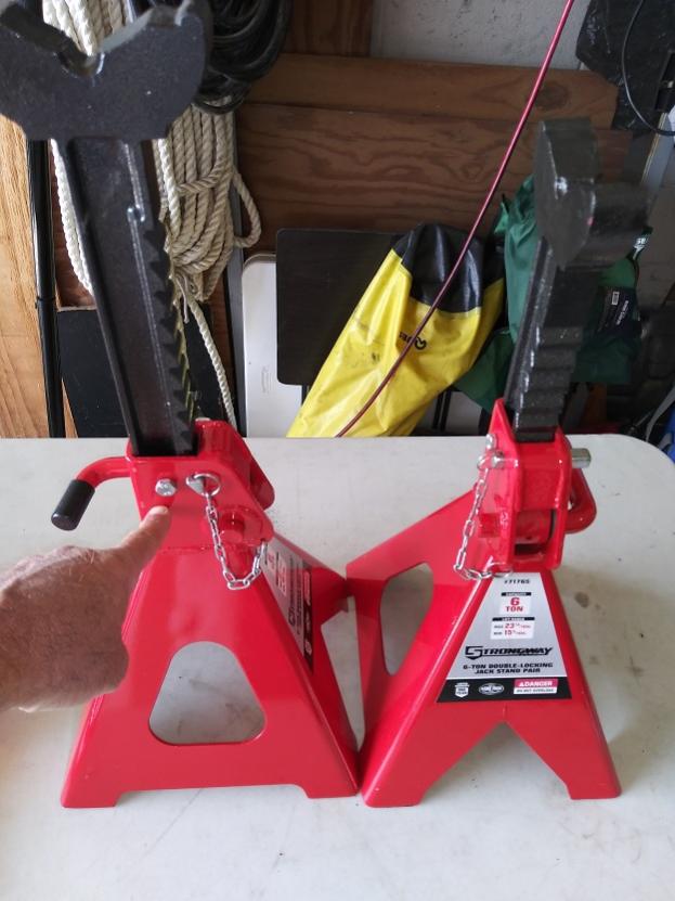

I returned a pair of HF that spooked me before. I replaced them with these 6 tons from Northern Tool
I like that they have a backup manual key to insert from the side to prevent unwanted movement. you can see it tethered to a keyring in the pic. check em out.
Strongway Double-Locking 6-Ton Jack Stands — 12,000-lb. Total Capacity, Pair
I received mine today. I like that they have a set screw to keep the saddle from falling out when picking them up. Northern Tool took their time getting them here is my only complaint. Beefy construction, pins are tight but have a smooth action and the saddle sits in there nice and tight with no wobble.

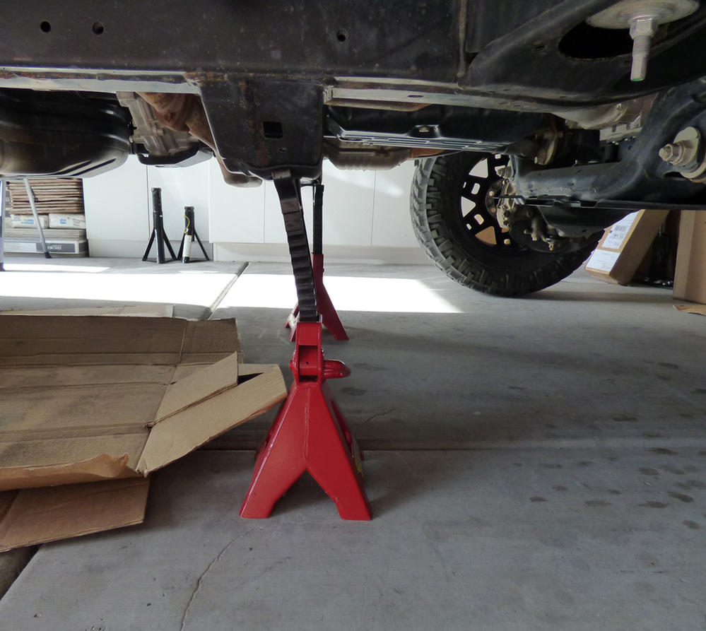

Used my pro-lift 6 tons, ratcheting with the extra safety pin added on on Sunday. They were solid while working on the ZJ.
I have not used stands with pins in them for 20+ years, and I have to say since the triangle shaped pin has 3 different length sides, it can be a pain to get it in the right way. It only fits one way. BUT - it's worth an extra minute or 2 for safety and they likely have to be shaped that way for a good solid mesh with the ratchet teeth.
