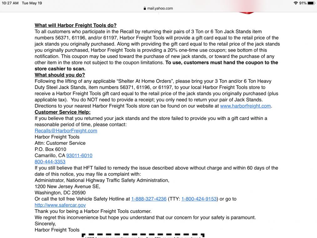

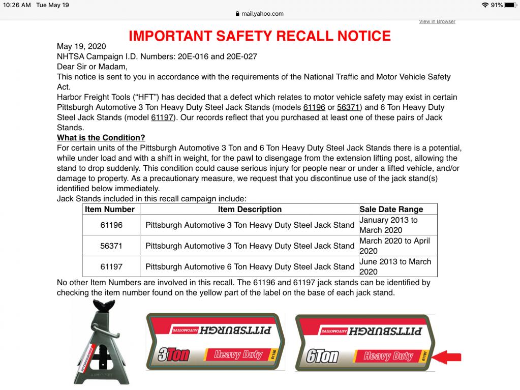

Finally got this damn recall notice in the email this morning as my local store is requiring it to show as proof to take it back. Drove down to my local store and as I’m wheeling a shopping cart with the jack stands in it, the cashier immediately asks me if those are here for the recall and says their system is not set up yet to process the recall to take them back and says come back tomorrow.
Wasted time and 4Runner gas going there.

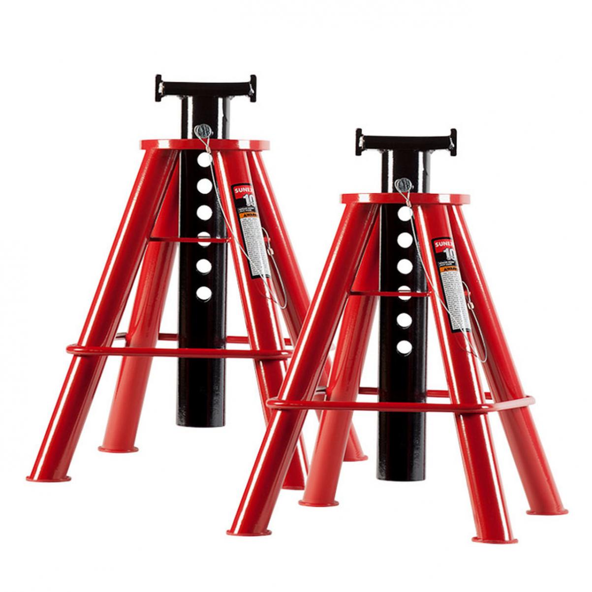

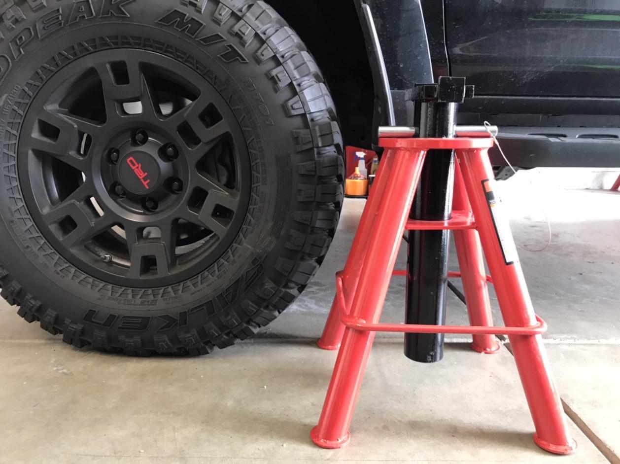

I got the Sunex 10 Ton jack stands as someone posted pics of them earlier in this thread. These are solid and worth the extra costs! They can probably hold up a tank! Perfect height adjustments for lifted 4Runners also. With these, I would feel confident that I don’t have to leave the floor jack or a spare wheel under my rig while under it for extra support.

Those sunex stands look impressive, but I think they're too tall for the work I do. (at least the 10 ton version)

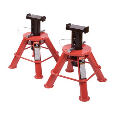

They have these itty bitty ones for lower vehicle heights.

Looks like the maximum lift height is 21”, that might be a problem with lifted rigs. I’d consider getting 2 of these if they had at least 23-24” of height. Cool set up though. I like the all in one package idea.
I have 2 of these (3 ton) and they work fairly well. Under rear axle and various locations in the front work perfectly with no problems. They will work under the frame rails as well stock or with mild lift. I have the eibach lift level and it will just barely lift the tires off of the ground using the frame rails but its close. They do work very well though (my regular 3 ton jackstands (i think i have a pair of craftsman and Mack truck and neither were tall enough to use after the lift). The safety interlocks plus having the hydraulic jack together seem fairly safe. As others mentioned i still shove a wheel/tire under just in case.

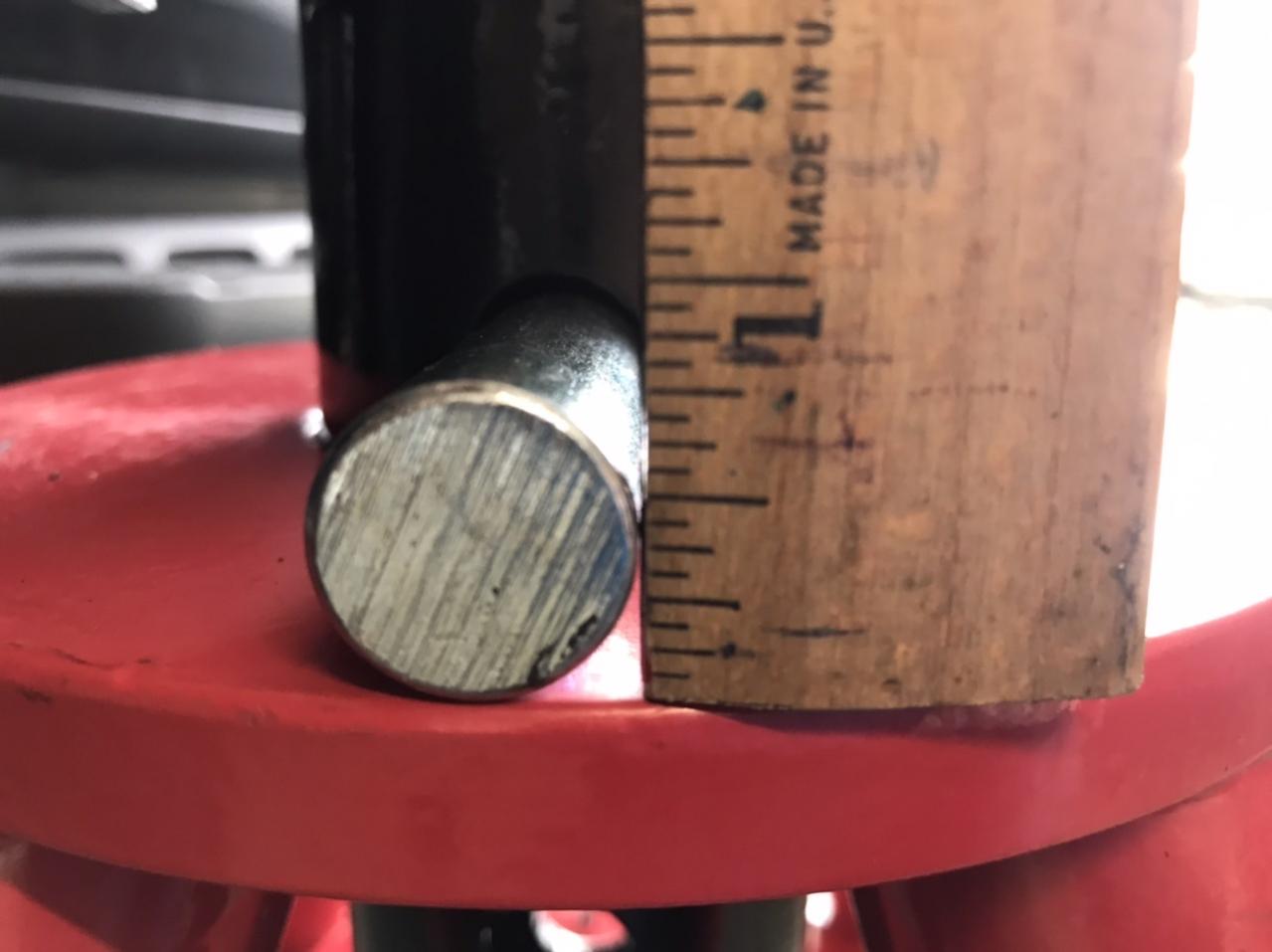

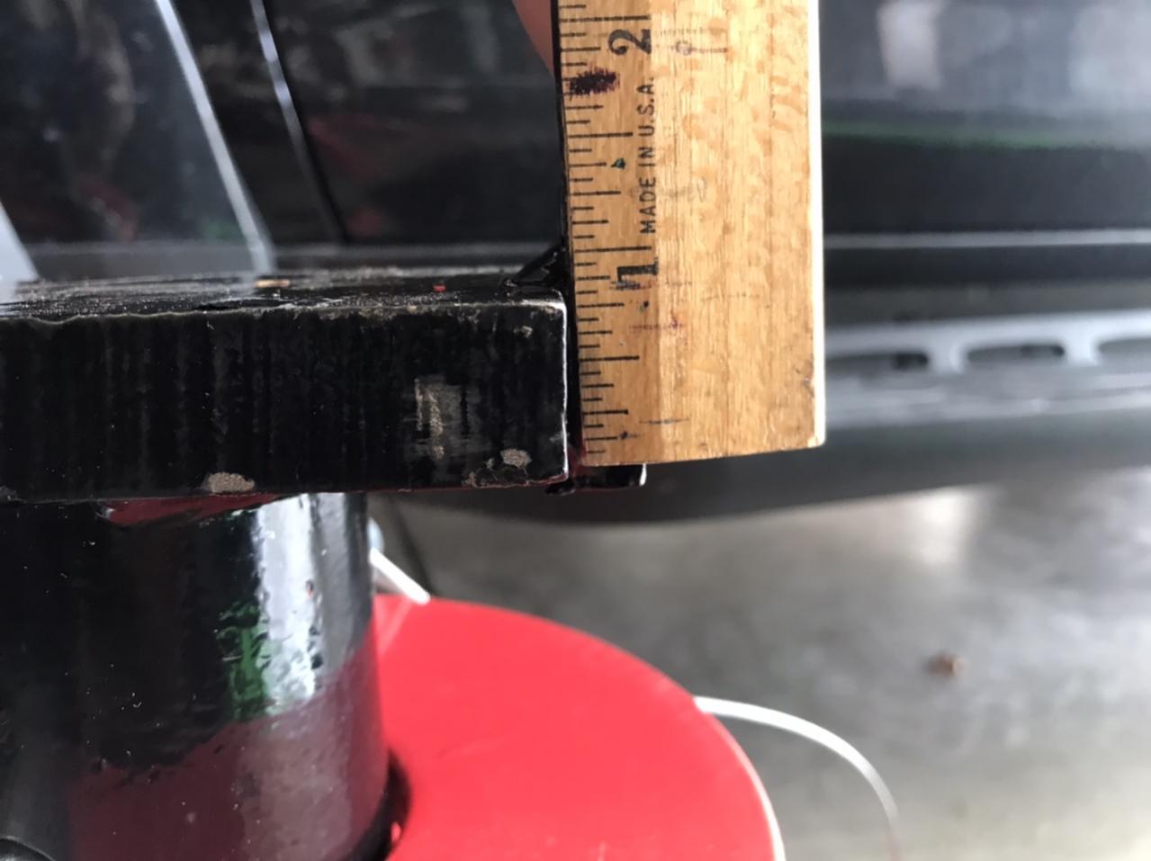

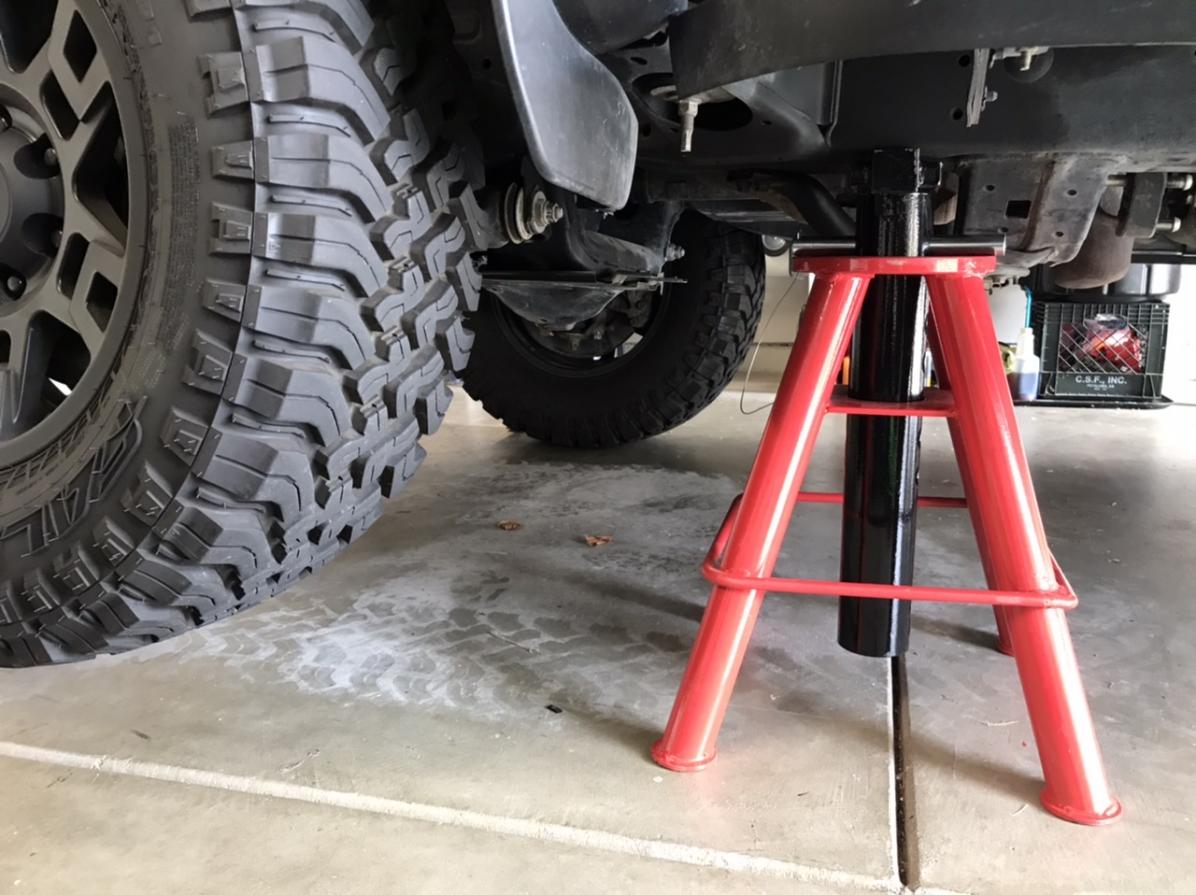

Here are the Sunex 10ton jack stands that I have. I have the steel pin in the first hole and the tire is about 3-4inches above the ground.
2nd pic is the show the size compared to my 285/70/17 tire. They are about 60lbs each.
The 3rd and 4th pic is to show the 3/4” thickness of the solid steel pin and platform stand.
These jack stands are stout and solid.

Those are nice, you cant really get any better than that. So sturdy looking!
