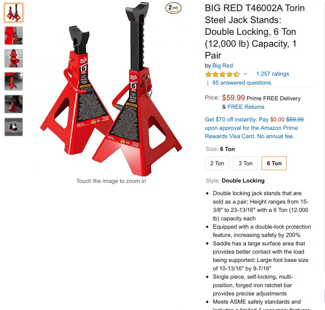

Picked up 4 of these 6 ton Big Reds by Torin a few years back at Tractor Supply and they have worked well for me. They have a 2nd safety which helps give a bit of confidence but I do as many others have said and use multiple layers of safety when underneath a vehicle.
Yes the safety clip is always an excellent idea. I seen other ones that have a pin as well that prevents movement. I just need to move to a lift or 2 then I wint need to use Jack stands etc. Anymore. :)

[MENTION=175921]TonyB66[/MENTION] I have that same jack and love it. Will probably buy another.

Guess who just ordered a set of the Torin Big Red stands? :D
