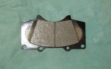

Here is a picture of the style of pads I received in the kit. I returned the kit and purchased the pads and shims separately for twice the cost.
On another note, I purchased Autozone calipers. They feel somewhat greasy. I was wondering if others have come across this on remanufactured calipers. If so, clean them with Simple Green, or such? Also, do they need to be painted? They seem to me to be a dark gray cast iron. I was thinking about picking up some of the VHT paint. Any concerns with getting some overspray on any of the parts?

Yeah, that is NOT the same pad that was in my kit. Perhaps the internet dealer pieced the kit together with cheap parts?

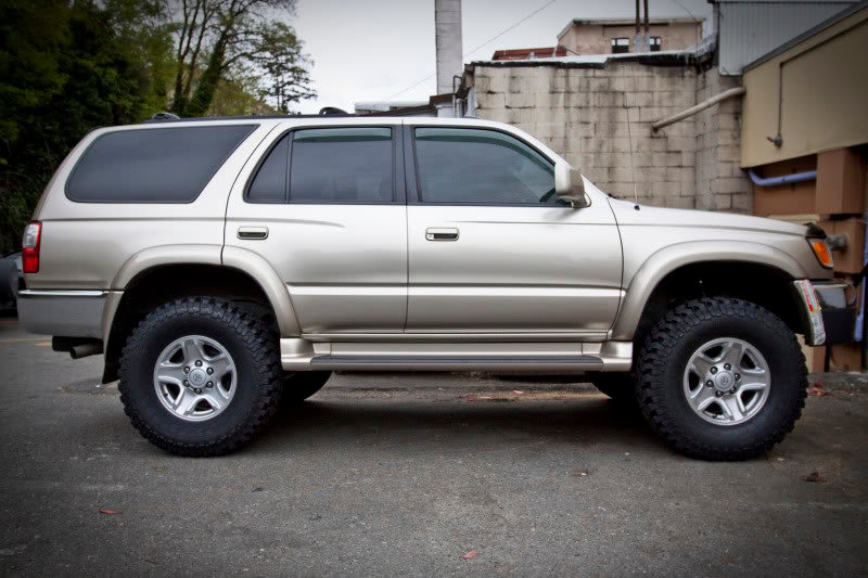

Just to clarify, this is not accurate. 5 Star wheels clear the tundra brakes, no grinding required. I have both. The 5 stars I am referring to are shown below. (thanks to Brilliant for the picture I borrowed; his picture is photo-shopped but that is not relevant to this conversation.)
Ditto; I also have the 5-stars and there is plenty of clearance for me - I'm talking at least 1/4 of an inch in most places.

I'm about to purchase some 5 stars (specifically in preparation of the brake mod) and that post startled me! I am in no way doubting BFAD, however, the last picture really clarifies which rims were talking about... 00'-02' LTD's. Thanks guys!

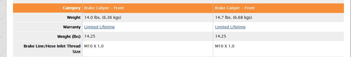

I ordered calipers from Autozone - both part # C9951. Now I'm thinking they cannot both be used for left and right side due to bleed plug. Is this correct? The other part # is C9950. On their website they list the weight in 2 different locations for each caliper. The weight matches for both calipers at 14.25 lbs in one spot, but differ from each other at 14.0 and 14.7 lbs in another spot. Let me know if I fouled up and need to return one C9951 and get a C9950. I'm pretty sure I do. Glad I didn't start this project quite yet.

My receipt (posted above) from autozone shows the model numbers for the calipers. I asked for the parts for a 05 toyota tundra 4x4 v8
Think you should be good.

I should be good after I return 1 C9951 and exchange for C9950, right? I believe one is a left-side caliper and the other is a right-side caliper. I've read you want to make sure the bleed plug is at the top of the caliper when installed. Please confirm.
