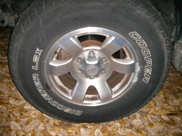

Hey guys, this is a great thread. I'm trying to find out if my wheels will accept the 213 calipers or if I'll have to go with the 199s.
They're 16" wheels. Has anybody with these wheels tried the upgrade?
Thanks,
Mike
Thanks,
Mike
Won't work. Unless you grind down the rim.
EDIT!!! I actually don't know. Those look deceivingly like the stock 16" 3 spokes.
Yeah, they're Enkei wheels and I haven't seen any mention of them in any of the upgrade threads that I've read.
If I go the Napa route, at worst I have to return the set of 213s for the 199s, right? Should I bother with measuring the current gap between the wheel and caliper and comparing that to the caliper measurements in this thread?
