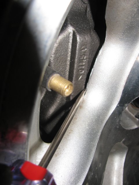

I should be good after I return 1 C9951 and exchange for C9950, right? I believe one is a left-side caliper and the other is a right-side caliper. I've read you want to make sure the bleed plug is at the top of the caliper when installed. Please confirm.
Thanks.
Seems you should return one and get a 9950. Call a local AZ and double check the part numbers with them.

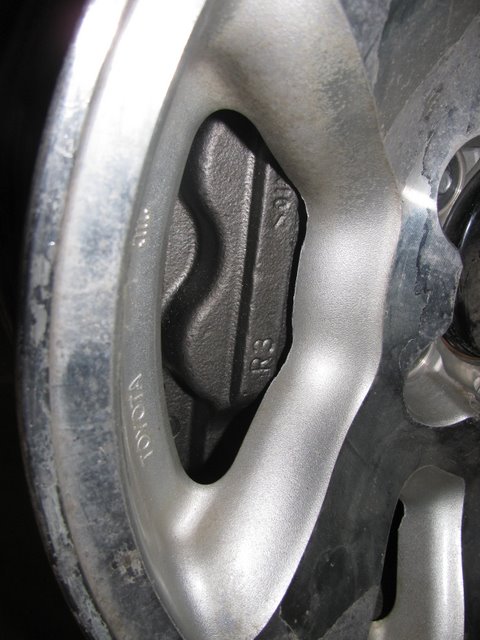

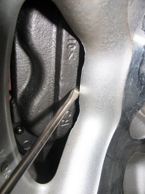

Do the 16" split 6 spoke clear the 231mm?
IMG_02541.jpg~original
photo from millerPKA
Also, how much time would you estimate it taking to do the fronts including SS lines installed and bleeding? A friend of a friend is doing mine and I want to have a fair price. Thanks!
No, they do not, and no your wheels are not on that list. That list only contains wheels that DO fit.
With all the research I've done, Sorry to say, (I have the same) no, they don't clear. They are not identified in the list of rims, in this thread, they commonly identified as "Split 3's". These are probably the most common alloy rim. Either you'll have to pickup some new rims or find some 5-star rims off of a 00'-02' Limited. I'm on the hunt myself for these, you'll probably have far less trouble finding some than I, in Canada. I'm having a hard time finding any parted-out donors in our wrecking yards. If I was willing to spend $400+, I would have little problem, but I'm looking at $200-250 used... that's what I paid for my last ones...

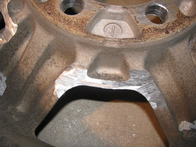

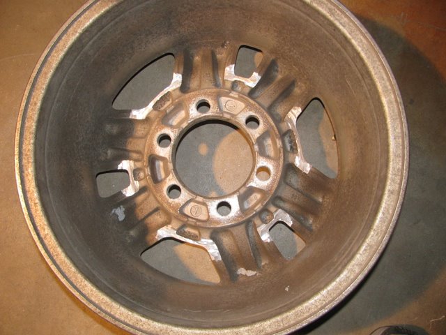

Split Three Spokes with 231mm brakes
Here are some pictures of a split three spoke wheel ground down to clear the 231 brakes.
This is my spare, as the stock steel spare does not clear the 231 brakes. I wouldn't recommend grinding these wheels for everyday use. Grinding the caliper is also a bad idea. Sell your stock wheels for whatever you can get and pick up a new set of wheels that fit over the tundra brakes.
I'd guess I removed about 3/16's of an inch of aluminum - just a guess.

Yea I don't know how I'd feel about those being my daily wheels.
If finding wheels is an issue the 199 is still a vast improvement over stock.
