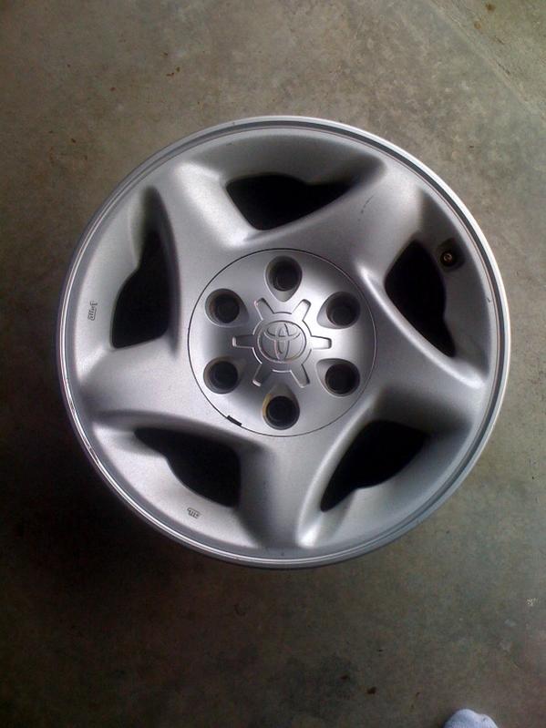

Is this wheel the one that you are calling "flower" wheels? Me and a buddy are both about to upgrade to the Tundra brakes, and I was comparing the clearance between the stock calipers and wheels on my '99 Limited "5 Star" (which I know will work with the 231s) and his '02 Sport Edition wheels. There was a good bit more clearance for mine than his, and we want to make sure that the 231s will in fact work with his.
Yup, that's what I was referring to as the "flower" wheel. Those should clear the 231's just fine.
