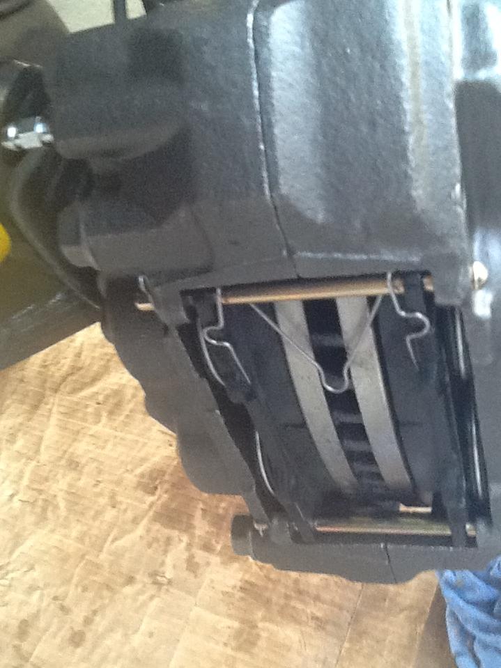

I recently ordered the rotors, pads, and shim kit for my 231mm brake upgrade from ToyotaPartsZone.com because they had the best prices and shipping. I made sure to order the pads without the chamfered edges (#04465-35290) to get the best braking performance.
Well, just AFTER it shipped out, I received a message saying that they replaced the pads with another part number. It was the #04465-AZ001-TM, which is not what I wanted. Here is what they looked like after I received them today:
PICT1872_zpsf0d8cd19.jpg~original
As you can see, they are no longer chamfered, but now have a large section of the pads removed completely. I will be returning these and ordering the full pads from ToyotaOfDallas.com. I already confirmed with them that they have the correct part numbers in stock.
So, I just wanted to let everyone know that if you order from ToyotaPartsZone.com, don’t be surprised if they replace part numbers and don’t let you know until after your order ships.

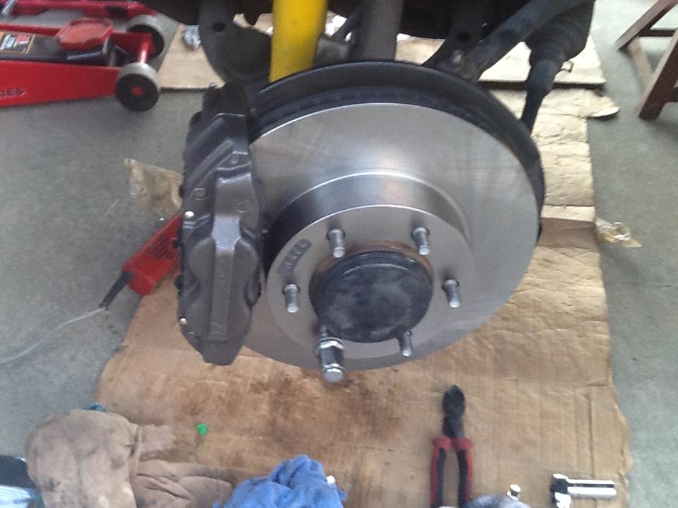

Did the 231 upgrade today, gotta say its pretty straight forward and took no longer than 1 hour. Did my test drive and noticed that I still have the vibration I had before. I am going to adjust my rear brakes by way of lifting the rear up. Is there anything else you may advise?

Thanks BigFish - Did mine in about 2 hours following your instructions. $325 All parts from Autozone. Only thing that sucks is my LC 80 rims doesnt fit. Going to add All Pro hub centric spacers. Tip - Use grinding wheel to cut dust sheild quick and straight and spray with rustolium.

Did this job yesterday. I now have the 231mm 13WL's and hot damn are the results different. My old 4runner calipers had nowhere near the stopping power of these Tundra brakes. I can lock up my brakes now, whereas before, I could have my foot to the floor and my brakes would shudder. Factory 3rd gen 4Runner brakes are plain scary. I feel so much more comfortable/safer driving my truck now, knowing I am ready for quick-braking situations on the road.
