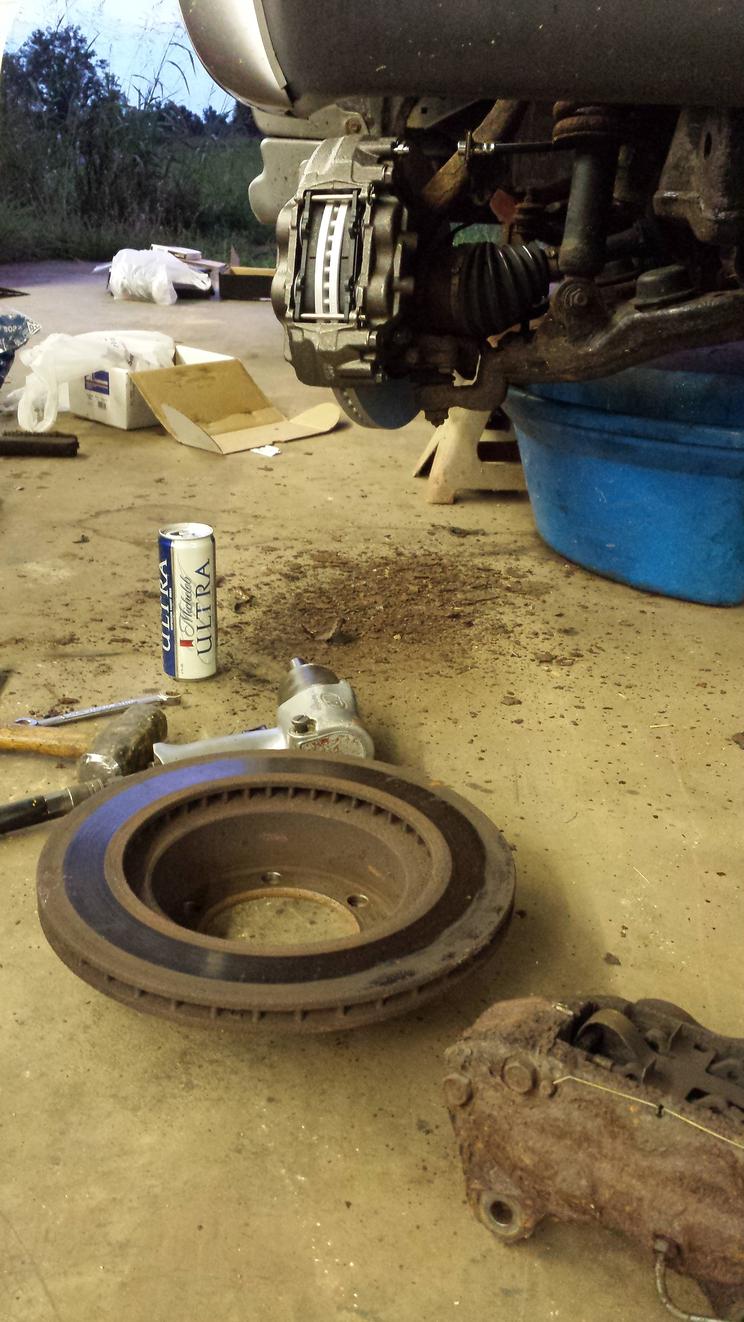

did the brake upgrade this wknd. Ive got some northern rust issues. Ended up replacing a few hard lines. My dust shields are the pile of rust under my ride. Any harm not running dust sheilds? I dont do much wheeling.

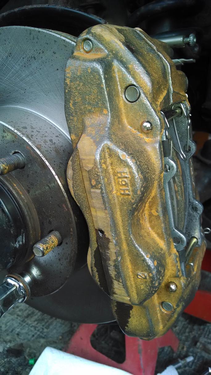

Brian - who's caliper is that? AutoZone? I really dont want to spend 300 and do all this work to look at my wheels and see that.
