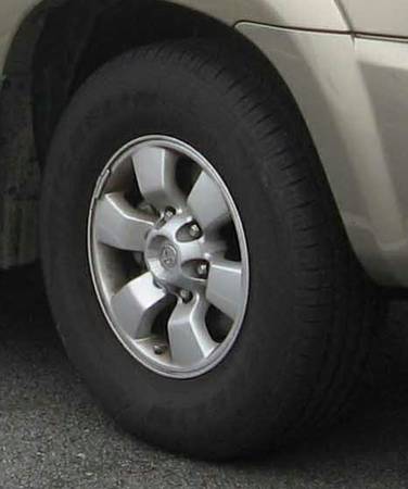

I don't want to grind my split 3s on my '98
Also, I just bought 265/70R16 new tires all around so I can't use the FJ 17s I really like on CL or other 17s
Is this rim below compatible so I don't have to grind ?
From 2007 4Runner on CL
http://images.craigslist.org/00u0u_jIoAy7comPA_600x450.jpghttp://http://images.craigslist.org/00u0u_jIoAy7comPA_600x450.jpg
Sorry trying to do this from iPhone

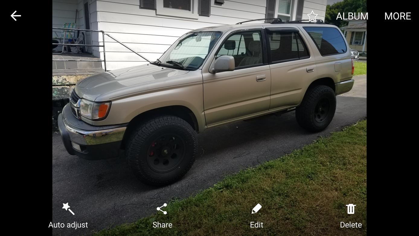

Powerstop upgrade with pro comp 7069
In the process of doing the upgrade with the powerstop extreme truck and tow kit. Down sizing tire size from previous owner who had 17s back to 265/70r16. Went with stock tire size as I previously had fitment issues and did not want to go through that again. Giving the pro comp at sports tires a try on 7069 rims. Wheels and tires look good, will post when completed tomorrow.

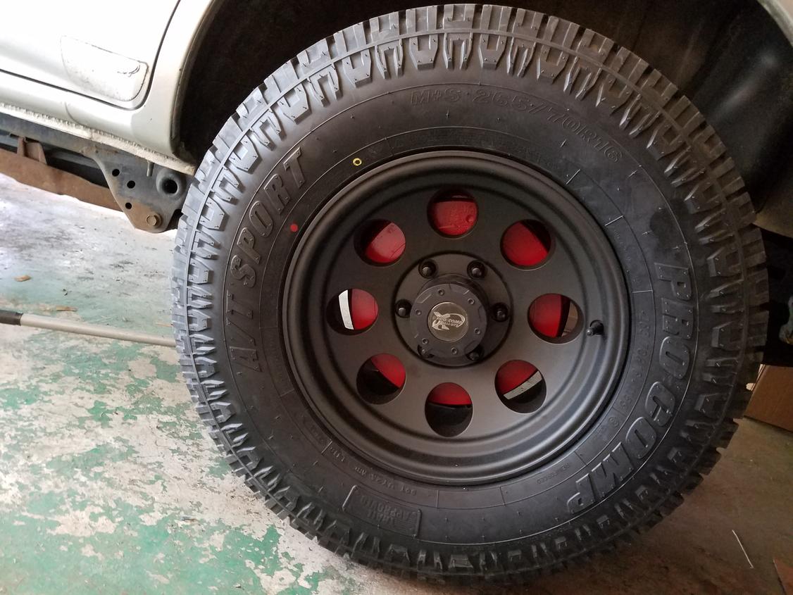

Everything went smoothly except for a problem bleeding the brakes. After 2 bleeds, realized I had the calipers installed upside down. Should have known when the brake lines wouldn't reach. Once those were fixed everything went pretty well, speed bleeders did help. Wheel weights came very close to hitting calipers, would try to mount those on the far inside vs the inside flat part if possible. Bedding brake process went well, with the blue film showing. Final product below.

Well, sounds like you learned a valuable lesson. When you mount them, make sure the bleeder screw is on top. Air travels to the highest point.
