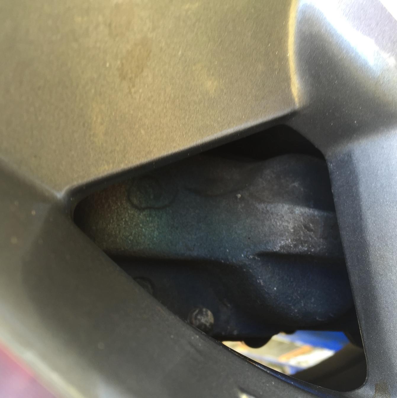

Wheel clearance
Will this upgrade hit this style wheel?
I'm interested as well does anyone know. I think this is the 09 trail edition 16" t4r/ fj.
Sent from my SM-N920T using Tapatalk

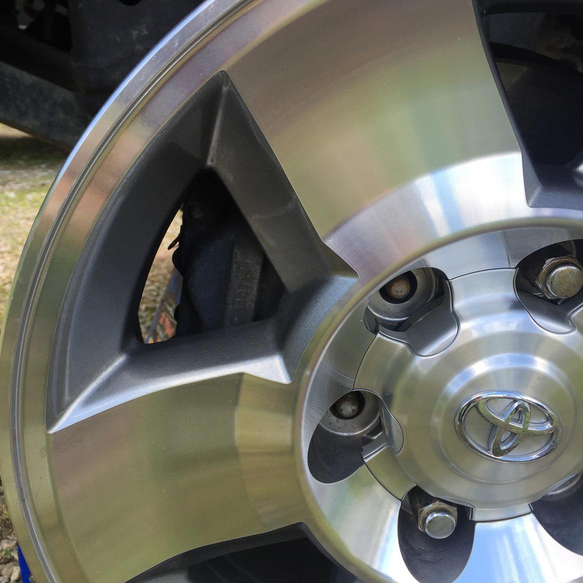

[MENTION=125751]jederberg[/MENTION] Thanks to [MENTION=92062]Yotaoffroad27[/MENTION] I was able to confirm that the 09 5-spoke Trail Edition 16" wheels that come on the FJC and T4R do clear the 231 Tundra calipers
[MENTION=44220]BigFishAllDay[/MENTION]. Thanks for your detailed instructions. You can add these wheels to your list.
Did mine yesterday and i knew my 16" 5 spoke Fj Cruiser would fit the upgrade thanks to this thread. [emoji1612][emoji1612]
