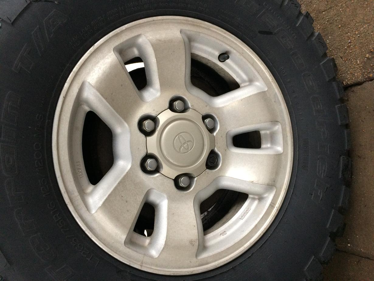

I have read thru the list that is supposed to fit but can someone tell me if these wheels will fit over the 231mm calipers
The wheel has on it 16x7JJ. I suspect they don't fit. You can zoom in if needed but the tire on it is a LT 265/75 R16
Here is a pic.

I've got those wheels and 231's. Not going to fit. You can grind the wheel, grind the caliper, grind both, get a .25" spacer, or get bolt on spacers.
I think they're all horrible ideas except bolt on spacers. I've got .75" bora spacers with no issues.
No they don't fit. I went through researching all this last week. I don't want to grind either the caliper or the wheel. I don't want spacers because it isn't good for the suspension systems and it might not be centred or balanced properly. I don't want to change wheels because I have a few sets of these exact wheels and I want them interchangeable. In the end I decided I would get the 199 mm TBU which is apparently also a great improvement. It isn't very hot where I live and I don't anticipate towing anything huge.
Here is a pic.
Thanks Ranchdog
damn it i thought those worked with the 231mm. i've got those on my 99 limited
