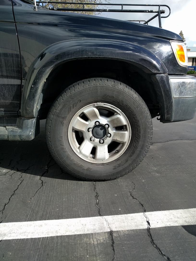

So I have no idea how you all refer to these wheels. The original owner told me they were the factory rims but I have no clue. They are 16" rims and I want to know if the 231mm calipers will clear them with no grinding or spacers. I tried to attach a photo. Any help or wisdom would be greatly appreciated. I apologise if I overlooked this in previous pages. I tried my best to search for an answer first.
I call them the split spokes. Not sure if that's right. from what I've seen is that they do require grinding. Was trying to figure out if my 1.5" spacers will work.

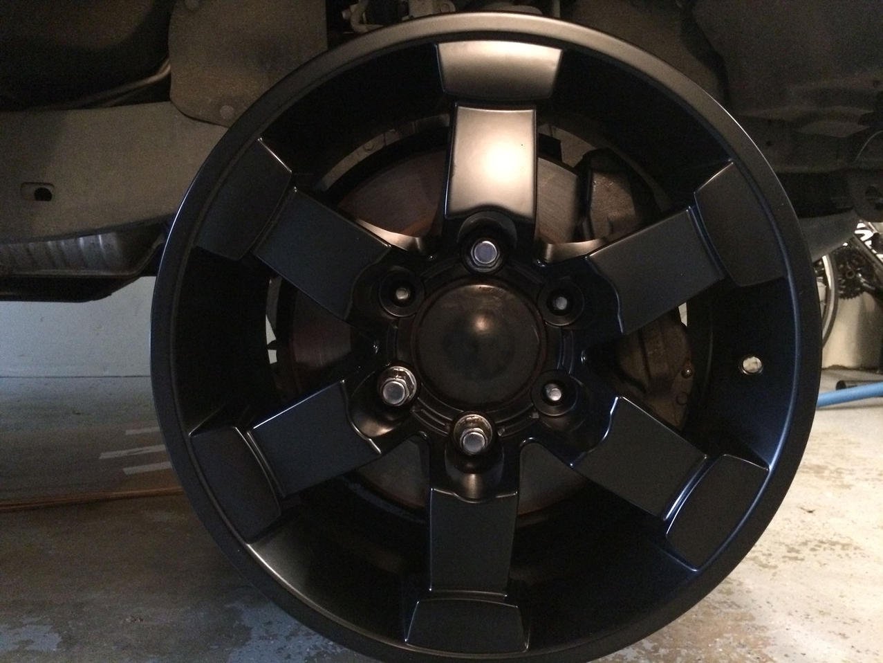

Please add TRD Team 16 to the list compatible wheels.
OP, could you please add these rims to the list? I had to scour the forums for several hours after not seeing it on your list. They clear the Tundra 231mm brake calipers...
Toyota TRD FJ Team 16" 5 spoke Wheels
