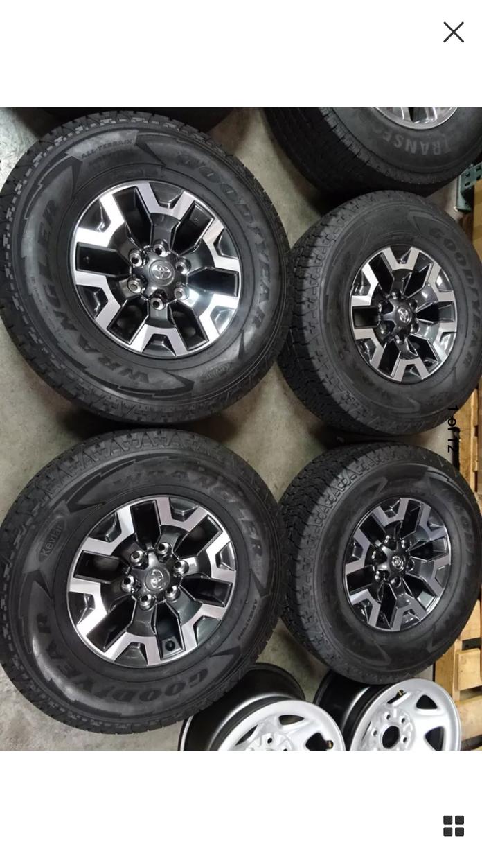

so i'm a little daft sometimes and although i've looked at the "yes will work" and "no won't work" pictures, can someone confirm the 99 limited wheels WON'T work with the 13WL's and that i NEED spacers?
The '99 Limited "star" wheels will work with the 231 size and the 13WL's. You will need to trim the dust shield, but otherwise they fit great.

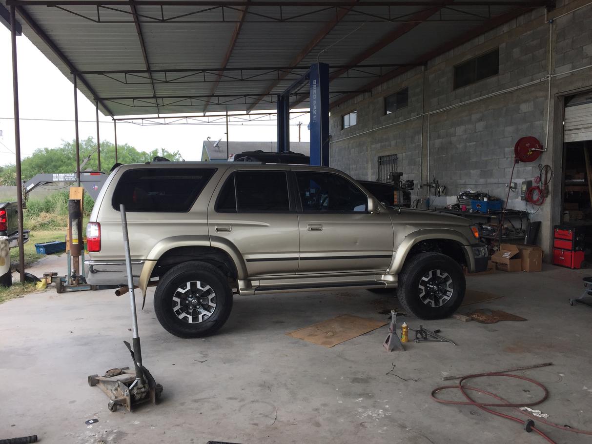

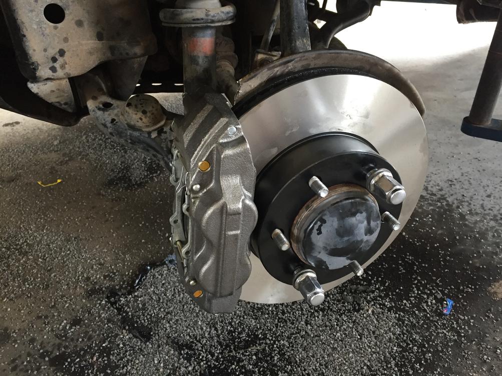

Just got my TBU done yesterday. Was worried the TRD wheels off a 2017 Tacoma wouldn't fit but they did. I've included the pic for reference. Also purchase the calipers on eBay for 150, the larger 231mm calipers. Got some Wagner rotors and pads on rockauto. The braking is tons better highly recommend.

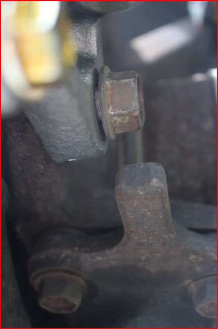

Hi, I'm finally getting around to upgrade my 98 4R to the 231 brakes! I dry fitted the calipers to trim the dust shield and check the rim clearance. I confirmed the TRD 'snowflakes' will clear as stated. I got a nice 5pc set for $240! - However, the stock caliper bolts bottom out and it leaves a gap between the caliper and bolt head. I measured the mounting ears on the stock 4R calipers and they measure 19.5mm the Tundra WL caliper measures 13.5mm! anyone else have this issue? Can I just use washers?? Trim down the bolts?? Are the threads supposed to be tapped through?? Big Fish seemed to have more engagement and get his to stick through, mine will not and I am sure I will damage the bolts if I try. I want to make sure I get the proper thread engagement and still be able to meet the recommended torque specs. - Any Thoughts?? - Thanks!
The threads are tapped through from the factory. How much torque are you putting on it that you think you'll break the bolt? Set your torque wrench to the proper torque and go until it clicks. I'm betting that sends them home.
OK...solved my own problem. Once I took the rotor off i was able to wire brush the threads from the back side. There was a lot of rust scale in the last few threads. Then I screwed in a bolt from the back side with some good ole' WD40 and sacrificed it to chase the threads. Worked like a champ! I'll have to replace one bolt but they tighten up nicely now. Thanks for the help though! :thumb3:

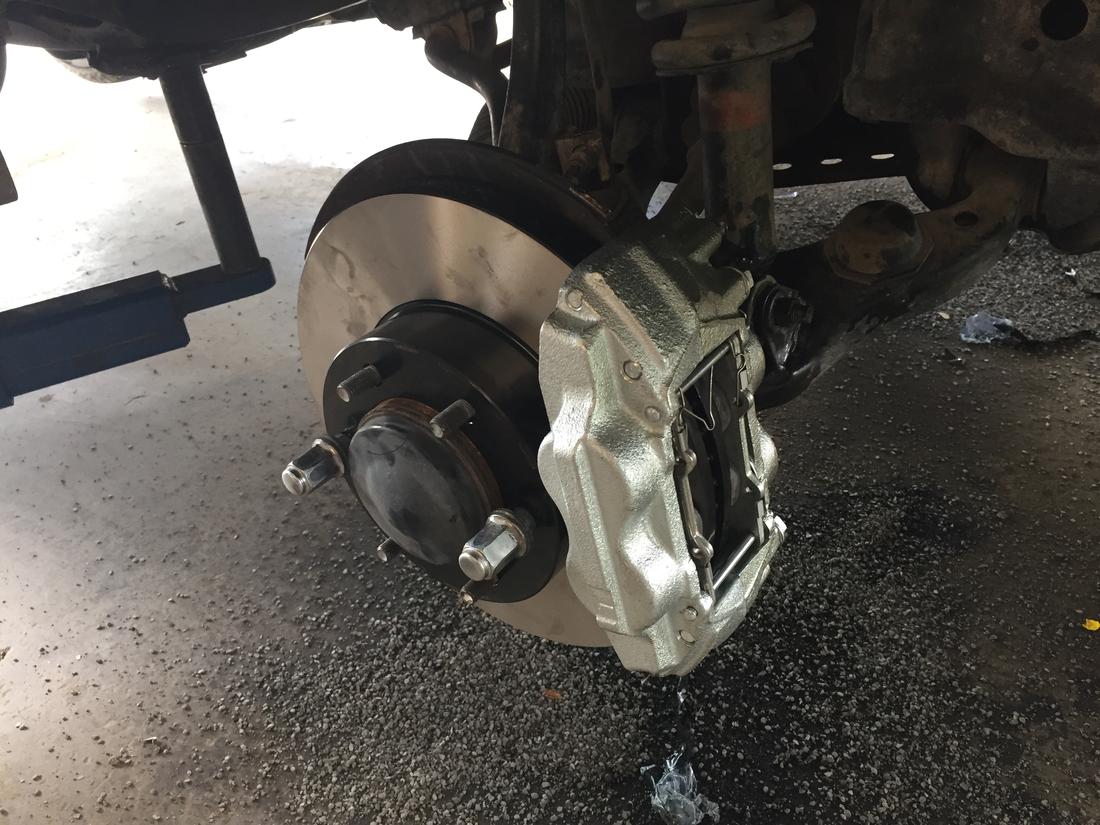

Nelsonmd - Do you personally know of the brake install pictured? I have the same flex line with banjo fitting on my Tacoma and was originally planning to just order 4Runner/Tundra brake lines but have found that it is not that simple. So my question is was any modification or dressing of the seal bearing face on the caliper required to get a leak free connection? Thanks for any info you might have.
[MENTION=164671]GrundleJuice[/MENTION] people have said that the braided SS lines for a Tacoma from Wheelers Offroad bolt on with no modification necessary, since you're concerned about the length differences. Otherwise, you just clearance the stock banjo bolt with a drill bit. https://www.tacomaworld.com/threads...-banjo-bolt-with-tundra-brake-upgrade.120871/
Twan, Thanks for the reply. I just came across a mention of Wheeler's having a brake line that will bolt straight on without mods but I couldn't find anything on their website besides replacement SS lines that appear to have the same banjo fitting as the oem. I sent them an email inquiry just now.
I have the rubber line going to a fitting and then to a metal line which bolts to the caliper on my 96. Ran the metal line still when I did the 231 swap. Ordered some Wheelers front lines yesterday as I was happy with their rear and they should be here in a few days. I can let you know how they come in the package.
