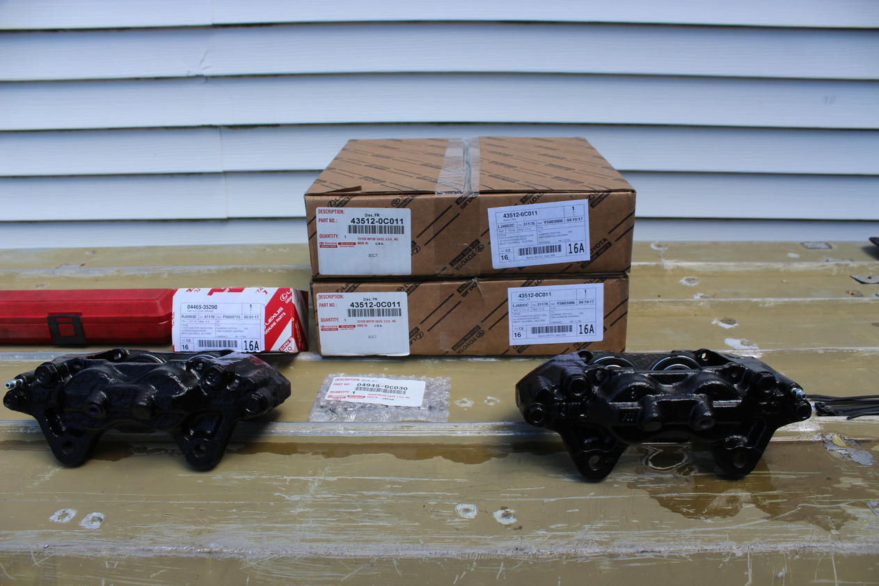

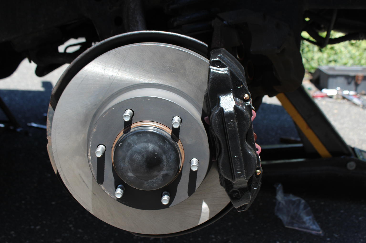

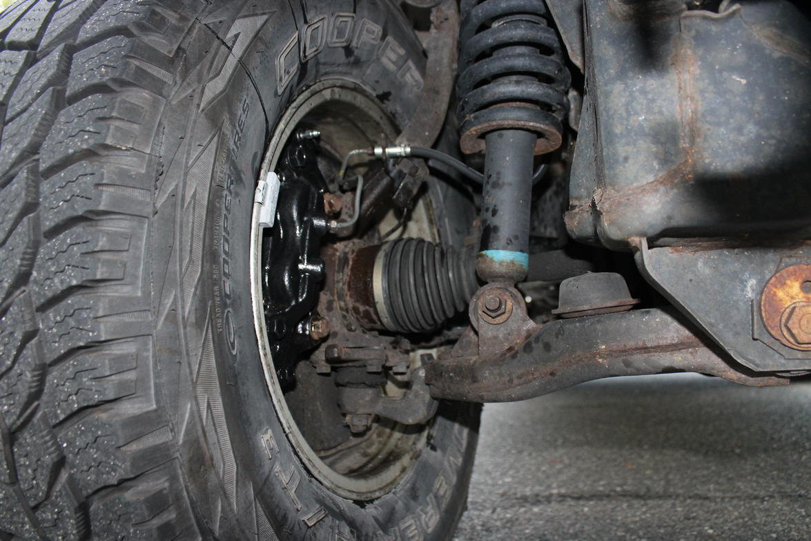

So...I completed my 231 TBU today!! Major thanks to BigFish for the detailed info on this upgrade.:thumb3: After my successful install I can confirm the following. The ABS functions just as it did with the original equipment! We had some brief showers today so I was able to test drive it on semi-wet pavement. And the ABS functioned great. The 16x7 Taco TRD "snowflake" rims provide plenty of clearance for the 231 calipers! And the bed in procedure posted by ALBPM, definitely helped the braking performance. One thing I did that seemed to help the bleeding process. I connected a plastic hose to the bleeder and hooked a 30cc plastic syringe (ebay) up to the other end and used it to pull the fluid into the caliper. I had to do this a few times and disconnected the syringe each time to reload it. But once I had a nice stream of fluid coming out, I pumped the pedal and bled the brakes as you normally would, only 3-4 times and I had a nice firm pedal, with no real noticeable difference in travel or firmness from the stock equipment.-Thanks to all who played a part in this thread!:cheers:

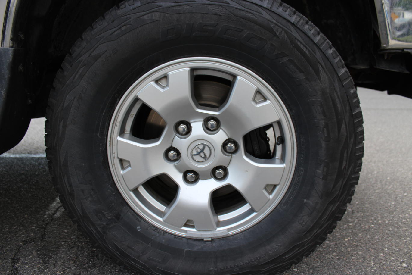

Hey all, T4R noob here with a 2000SR5. I've been looking at this upgrade and was concerned about the wheels that came with my truck (first photo). Then I saw a tundra parked on the street with the same rims (second photo - note the larger rotor).
Are these in fact tundra wheels? They look identical to mine! Fingers crossed that I got lucky...

You've confirmed I actually lucked out with the right rims on this purchase. Now all I need to do is find the roof rack rails..
