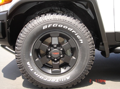

Hey guys, finally getting around to some projects on my runner. I just went through this whole thread again (as well as the links for yoda and tacoma sites) and noticed the pictures of the wheels have timed out with age. Can anyone confirm if the 231 13WL Tundra calipers will clear the 16" FJ TRD wheel pictured? Thanks so much!
Bueller. Anyone confirm? Trying to knock this out this weekend.Thanks!
