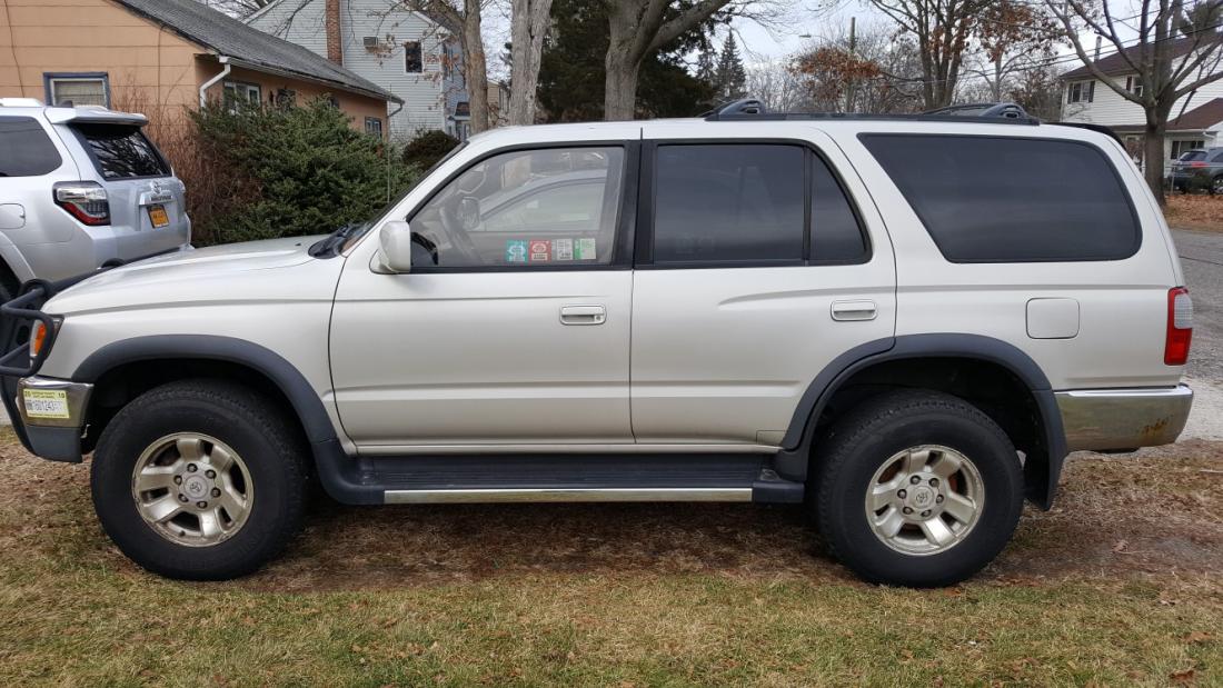

Hi All
New here and new to my 4runner which is a '98. I'm pretty ignorant but I've been reading as much as I can here, great forums and I appreciate all the info here.
I need to know if these wheels will clear the 231mm calipers if you could help me, please. Also, what is this style of wheel called?
Thanks,
Andrew
Hi All
Thanks,
Andrew
Split 3 spokes
231s wont clear those rims. You'll either need to grind the caliper, grind the rim or use spacers. Or you can do 199 Tundra brakes.
Search "Split 3 spoke tundra brakes" for more info.
Or they might not fit at all. The split 3's came in 15" and 16". If you have the 16" you can run spacers, grind, or run the 199mm calipers. If you have the 15 inch you will need new wheels.
JRZEE and JBURT, thanks for the replies and solid info. I have the 16"s but don't want to grind rims or calipers or put spacers. Is it still an improvement using the 199mm rotors?
