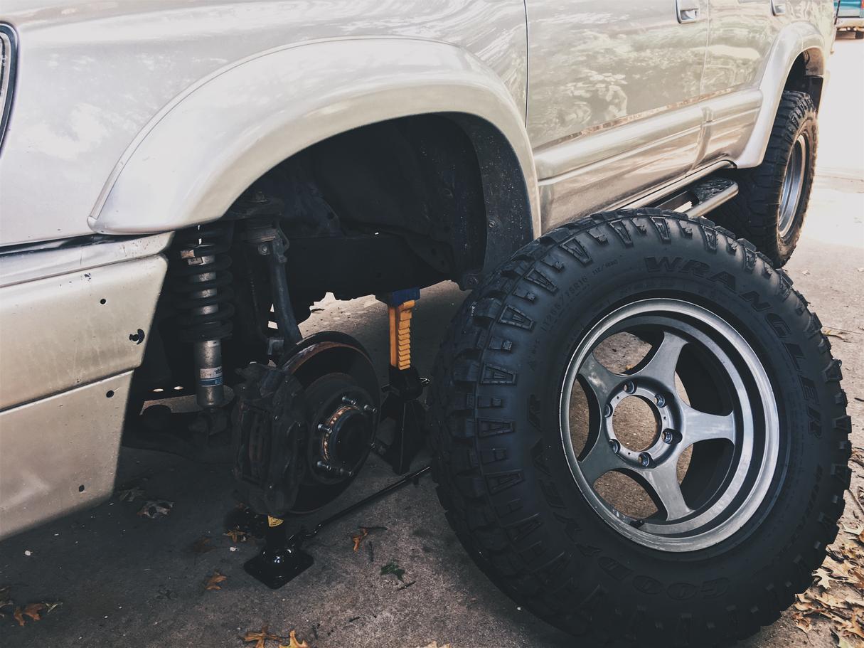

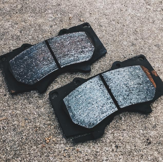

I called up Steve at Sonoran Steel to source all the weirder parts for my TBU since they make it so convenient in a little kit (with the non-chamfered factory brake pads like I wanted), and he gave me the same talking points. I went ahead with it and have absolutely no regrets (I also called up Wheeler's Off-Road for some stainless brake lines). I did have to mash the brakes very hard one time in the 30,000+ miles I've had them on and they did NOT lock up; but they sure stopped fast like I wanted! I do have 265/75/16 E rated tires, and now have a 3/4" extended steering rack cover that's over 50 extra lbs. up front so the TBU is warranted. Theoretically if you had F1-level race brakes on a 1970's bicycle tire then they'd have a point, but the 231 upgrade from 199 isn't the massive step-up to overkill that they've hyped it as. Can't blame them for covering their butts on the legal liability front though.
