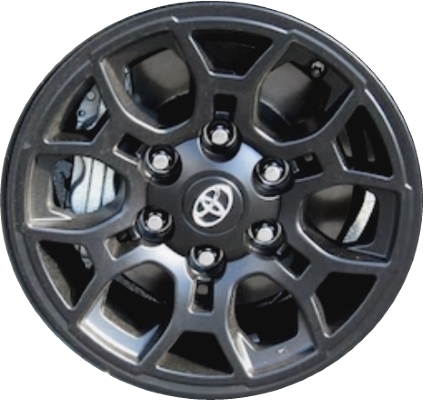

SR Tacoma Wheels
Hello, first time post for these forums. I've spent the last couple of days reading the wealth of information in this thread. I have not seen if anyone is running the sr tacoma wheels with the 231mm calipers.
Does anyone on here have experience with these wheels and the tundra brake upgrade without spacers?
Any input would be appreciated try to figure this out before I get new tires.
