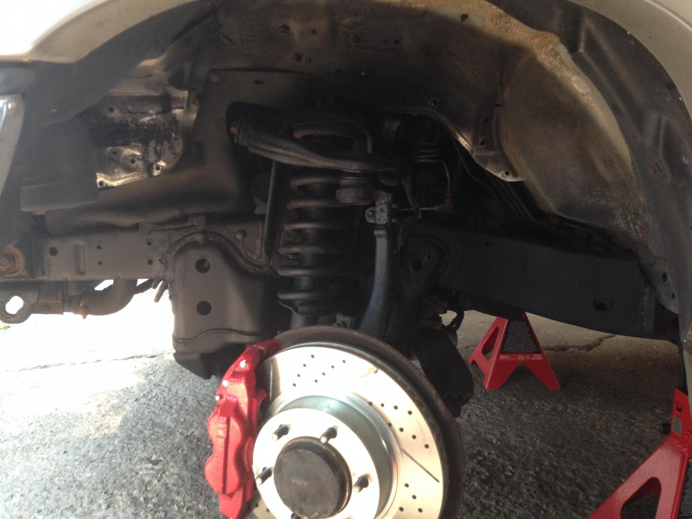

Since I had a difficult time locating the part number for the spreader clips / anti-rattle clips here it is: 04947-0C010
Each part number comes with 2 spreader clips and they were pretty cheap. A couple bucks if I remember correctly. Anyways, only 1 clip per side is required but I put 2 per side because I had ordered 2 sets of what I thought was only 1 clip which means I ended up with 4 clips instead of 2 like I thought.
Took a few hours but everything went pretty smooth. I may of cut a little bit more of the dust shield but I'm happy.
Got mine installed with extended stainless steel lines!
