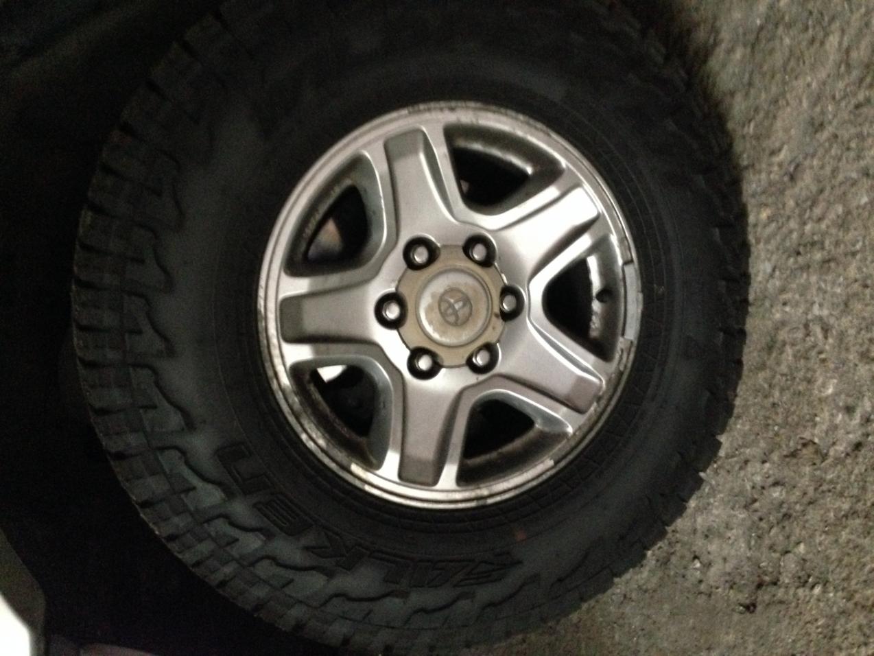

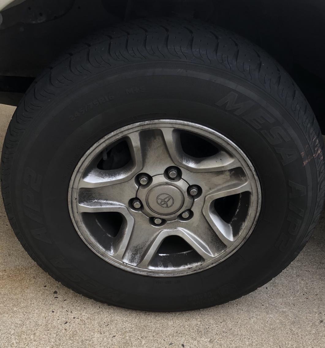

I want to upgrade my brakes to the 231mm. I was wondering if someone can tell me if my stock rims will work. Thx for help

The answer in at the bottom of post 3 in this thread.
And just on the off chance that engrish isn't your first language, you're looking for the word "brake", "break" is something no one wants to do to their truck.

Want to do the upgrade. From what I read, this stock rim should fit without any grinding off. Just trying to confirm before I pull the trigger.
Read the thread, you dont even have to leave this page to get your answer. :keyboard:

dude! I didn't even see that top post. After I read a dozen pages and check other threads. I just snap a pic and asked to double & triple check. Kinda why I lean toward this model when i purchased my first Runner. Thanks again!

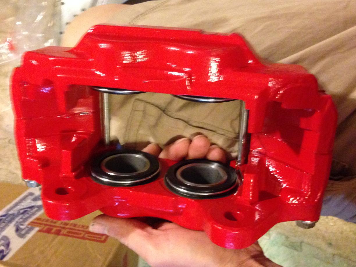

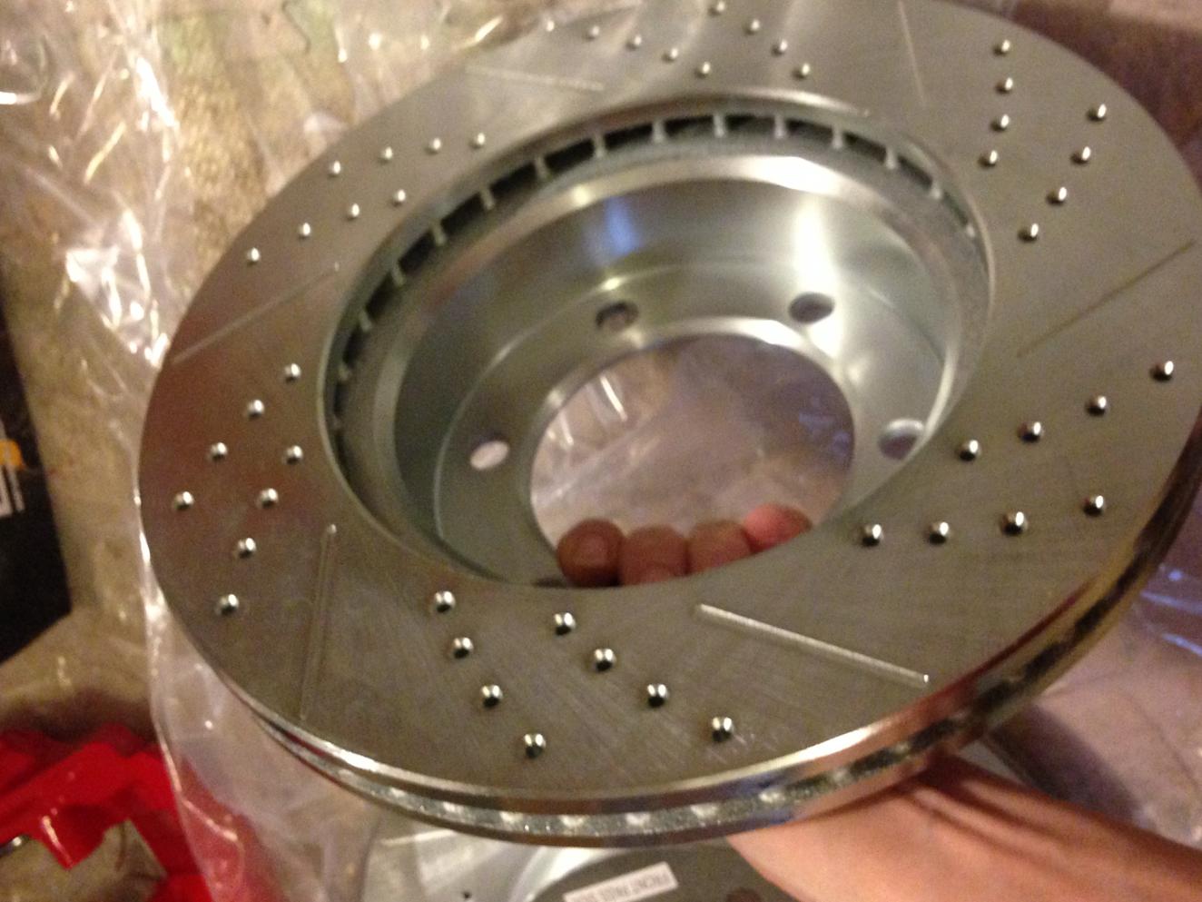

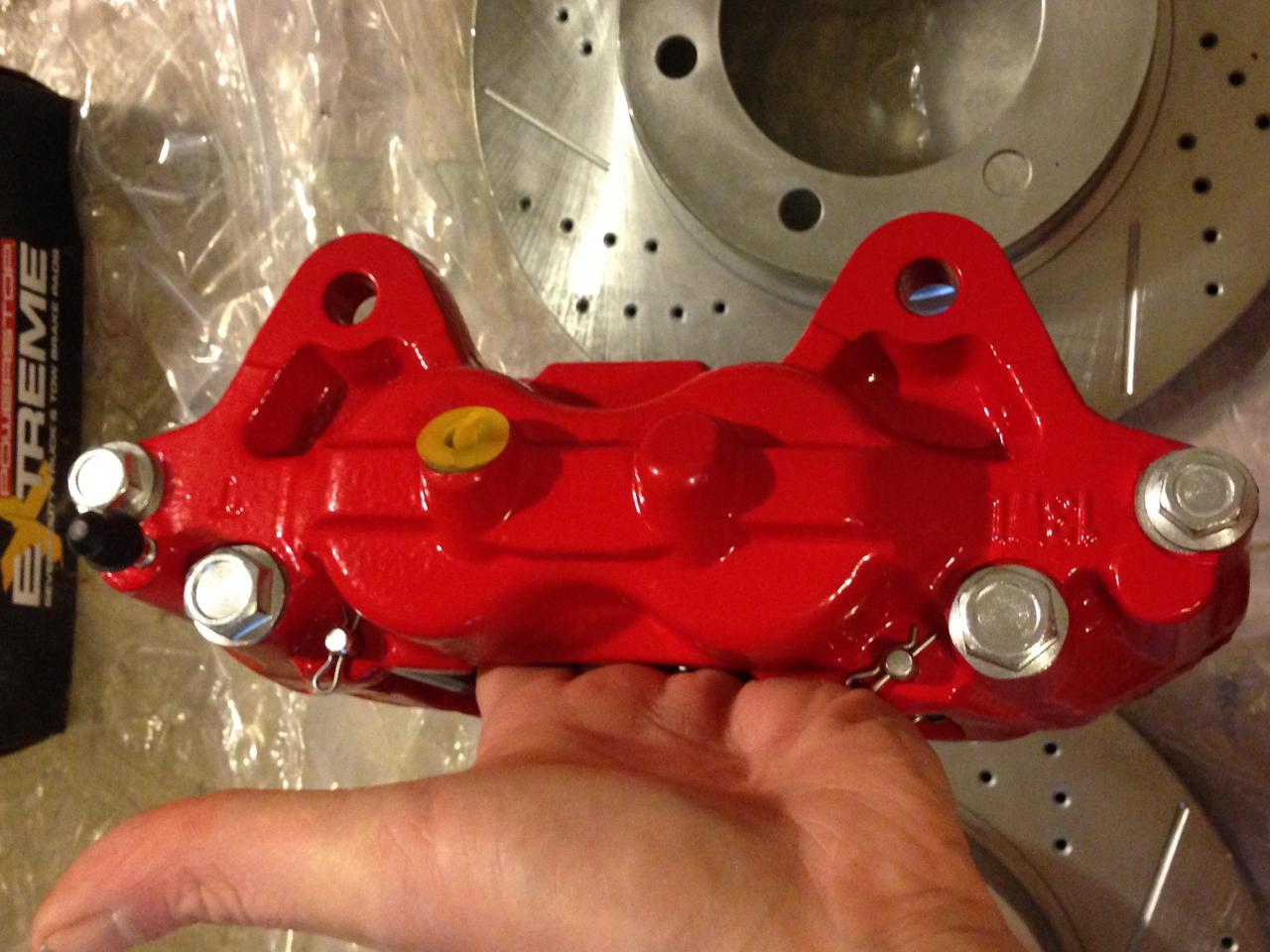

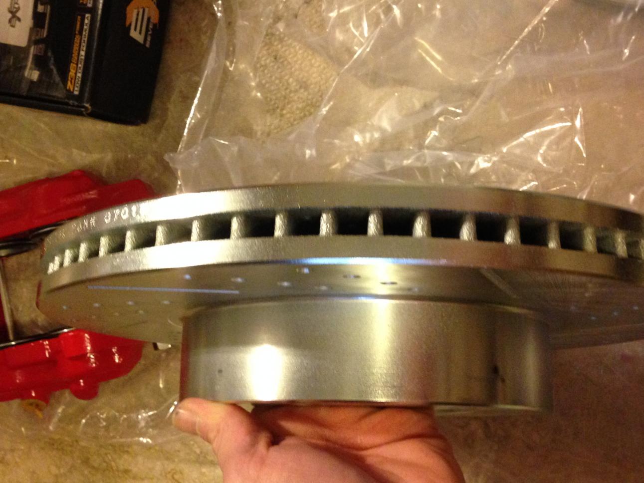

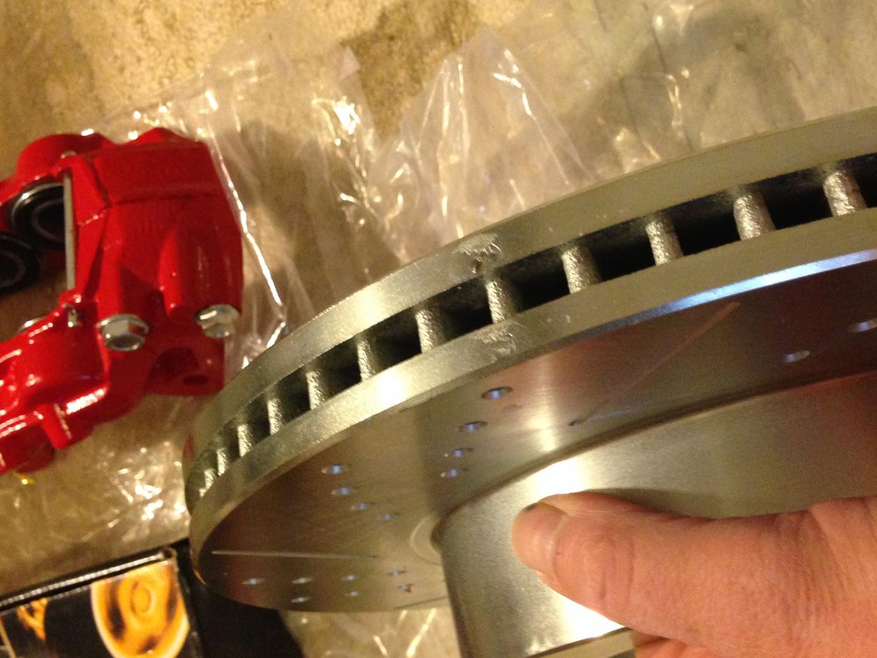

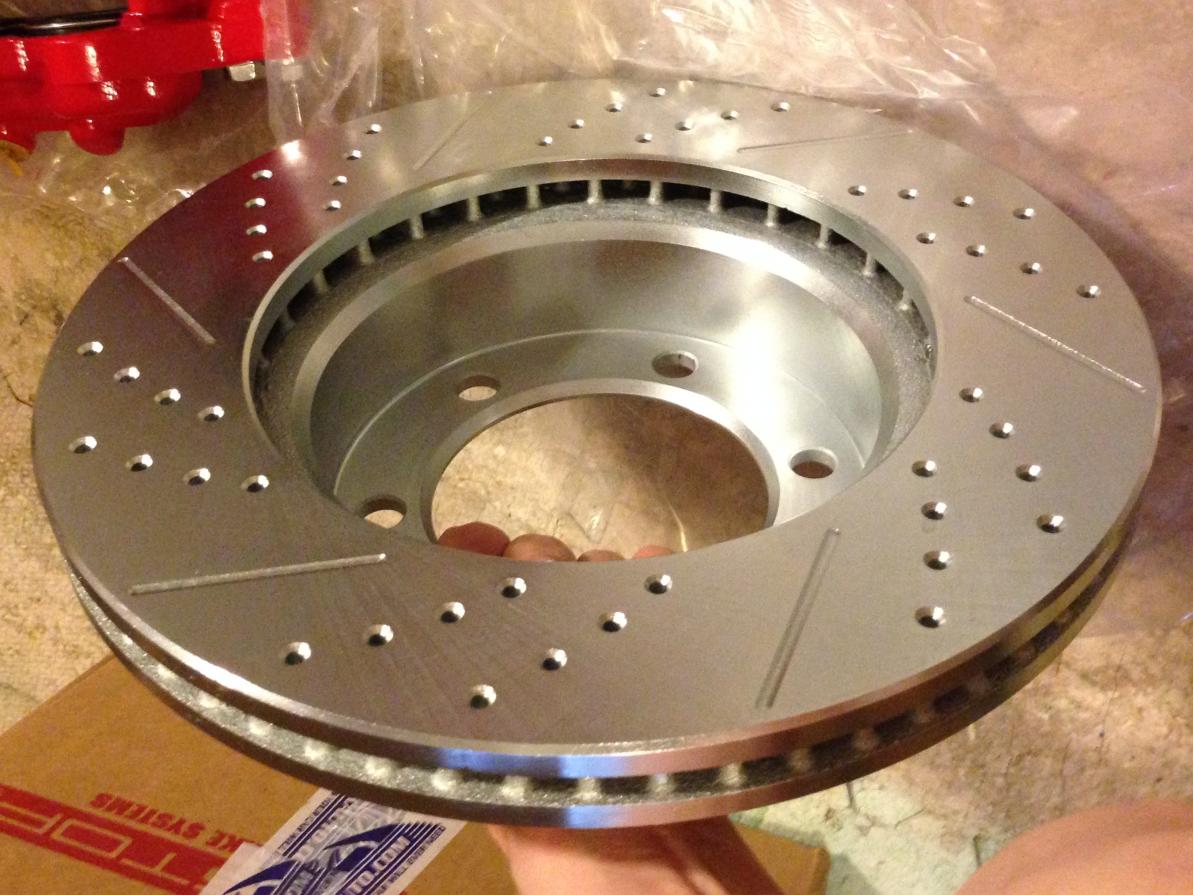

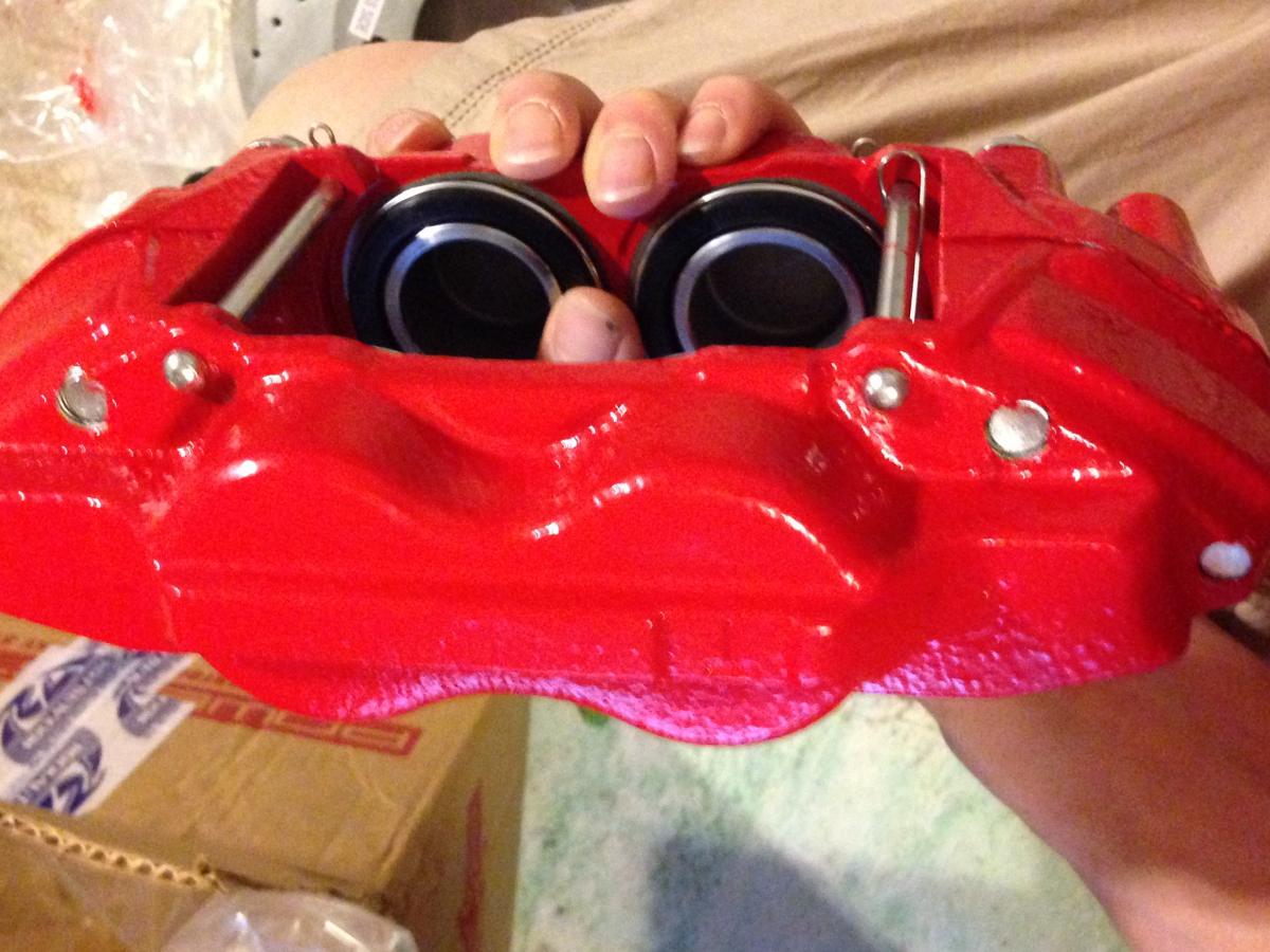

So I went ahead and purchased the Power Stop tow package. Looks fine to me. I went for a few days looking online to try and get something decent. Now just waiting to get the time next week to try and nock it out. The only imperfection was on one rotor. Don't really think it'll be a issue but just cosmetic.
