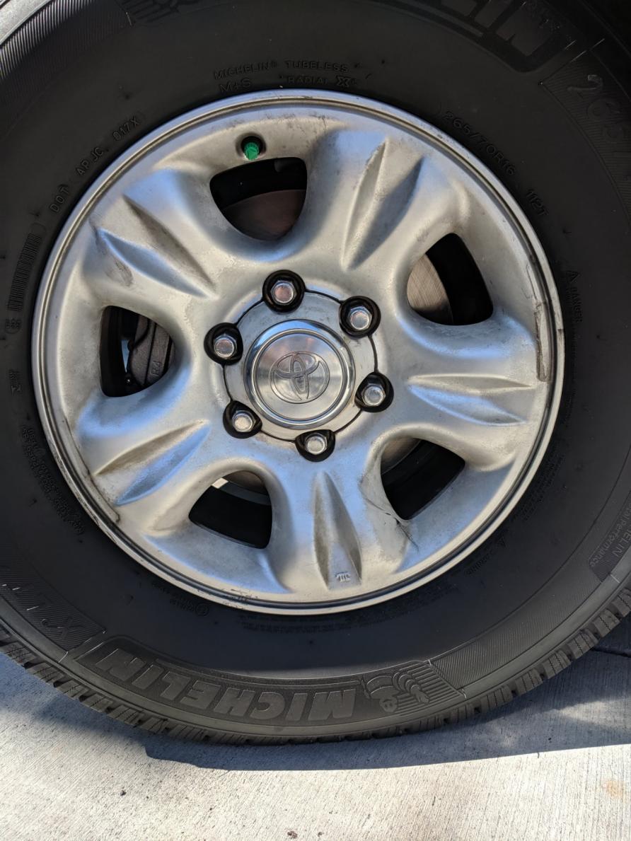

Also, (please), tell me these wheels will do:

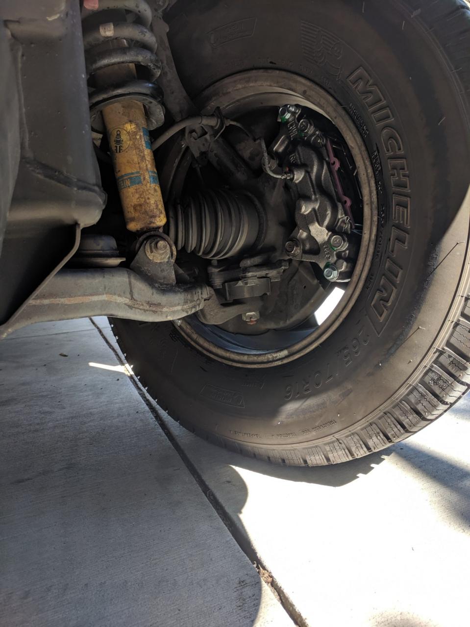

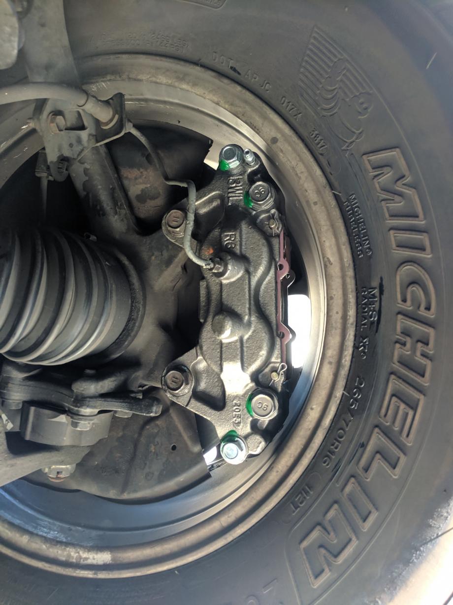

So I finally did the 2005 TBU. I went with the 231mm- 13WL
On stock 16" OEM 4-Runner 5-Spoke "Flower" Wheels, found on '01-02 models. I did zero modifications to the wheels or calipers to make it fit.
I've been driving for about an hour; the breaking feels stronger, controllable, bites immediately, and no more gliding to a stop.
There is a little more peddle travel that will take some getting used to.
I've owed the 4Runner over 10 years and should have definitely done this modification a lot earlier.
Parts Used
231mm-13WL Calipers From Auto Zone- C9951(Driver) C9950(Passenger) 89.99x2
OEM Rotors- 43512-0C011 2x$64.37
OEM Brake Pads- 04465-35290 $63.75
Thanks to the 4Runner community for the help, information, guidance, and part numbers. Hope my post helps someone!

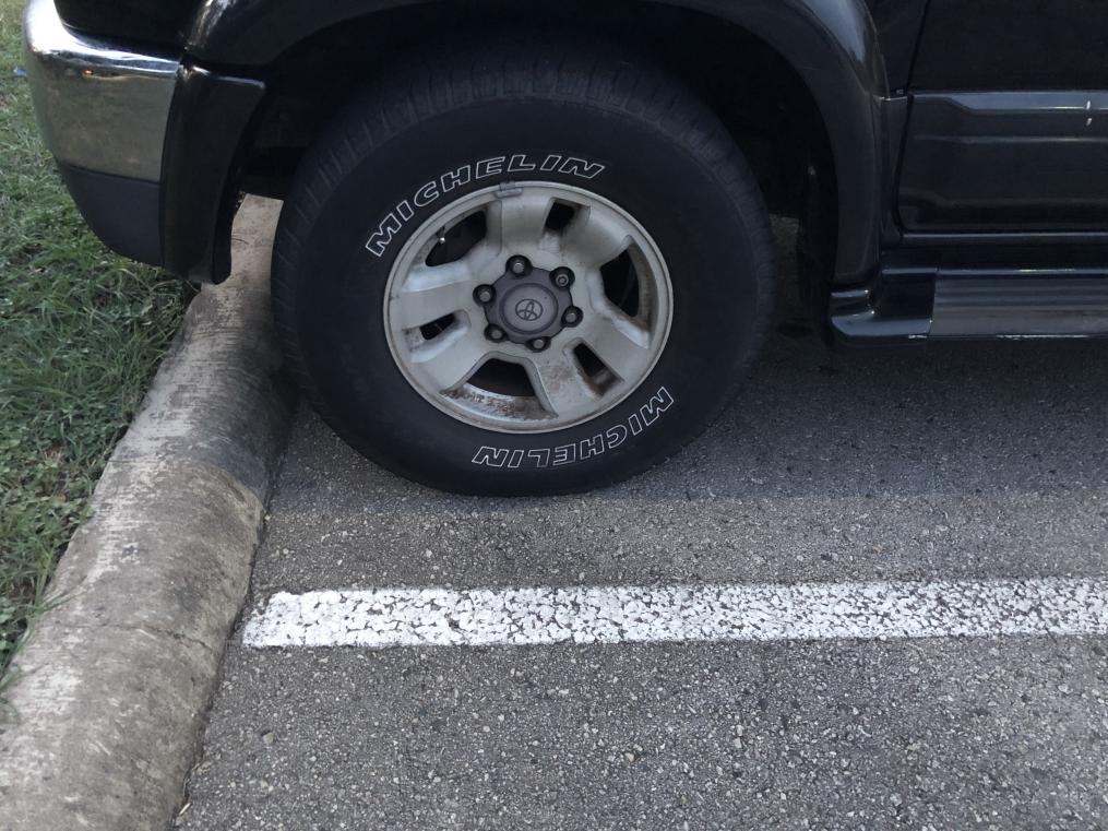

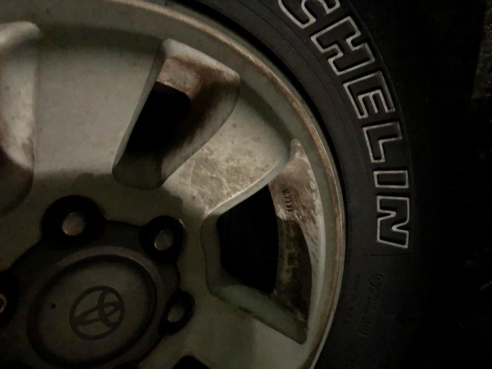

I have a 97 2WD Limited 4Runner.
AFAIK, the wheels are stock and say 16x7 JJ. There’s a picture a few posts back. Can you or anyone else please tell me if I can use the 231mm Tundra 2006 brakes? Please.
What's the post number? Lots of photos of wheels in this thread.
[MENTION=222661]slmatrix[/MENTION] I don't think 231mm will clear those rims. Those are known as 16 inch split spoke oem rims.
