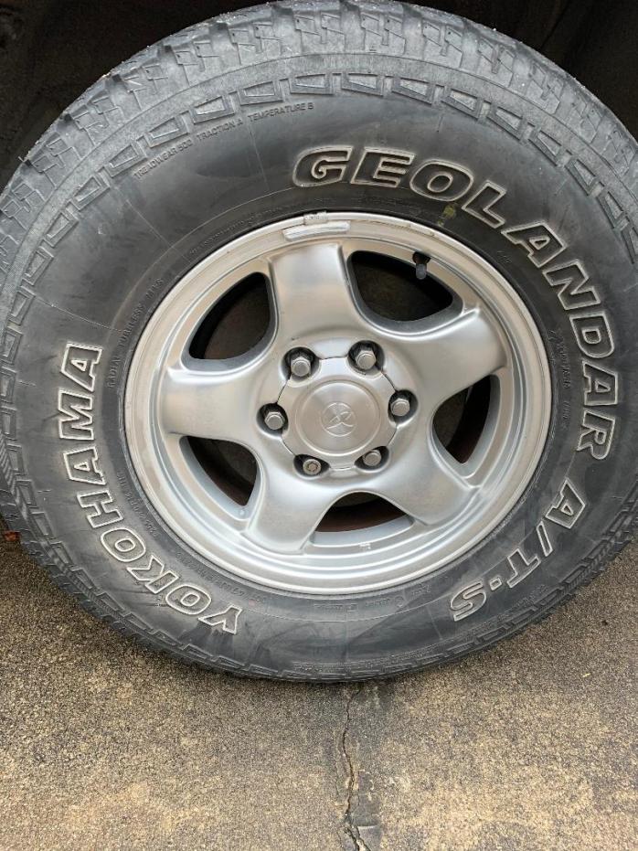

I'm wanting to do this upgrade soon, but I have a few questions. Will the 231 fit my stock 16's? I've tried looking for the same wheel but couldn't find anyone else running them. If they don't fit I have no problem getting some 17in wheels but don't know what size KO2's to get where I won't rub w/o getting a lift. Sorry for not starting a new thread but this is my first post and I wasn't allowed to yet.
see the very bottom of post #3 in this thread.
The pictures don’t show up for me when I click any of the links, it said they are lost when redirected to photobucket. Or I’m just an idiot, I’m hoping it’s the dead links and not me ��
the info you seek is in there. you just likely cant see the photos because of the photobucket fall out (i cant see them at work here). but the info you need is where i told you to look.

Infocus325,
This helps immensely. I have the same rims on my T4R and was having a hard time confirming if the 231's would clear the rim, but you proved they do!
On a side note, how are the Autozone calipers holding up?
Yes, the Tacoma rims fit fine. I’ve run them on 2 rigs with the 231 tundra brakes. Have that exact setup sitting in the driveway now.
I think it would be easier to list the rims that don’t fit.
The only 16” rims I’ve seen not fit were the Stock 4runner split 6 rims.
I’ve run the remanufactured calipers from Oreilly’s on a few rigs with no issues. It’s just shy of $500 to walk into an auto parts store and buy the entire conversion.
But oh so worth every penny.
If you go the reman route open and look at them in the store. Sometimes they will have different bleeder bolts. You want both to have the same bleeder bolt otherwise it’s annoying.
Are you referring me back to the op’s list of “will fit”
yes, post 1142 instructs you to a very specific list. the wheels you seek are one there.
although i will say, its a lot of info to digest over 3 posts. i just know its on the bottom as ive read through the OP a bunch of times.
This is the bottom of Post #3. Where do you see the Tacoma 16" rims model # ALY75189 on that list?

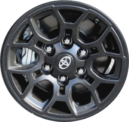

The person was asking about 3rd Gen Tacoma rims per his picture.
The Bold is the 2nd Gen Tacoma rims (2005-2015).
16" 2nd Gen Tacoma "Snowflake" TRD Off Road wheels PIC

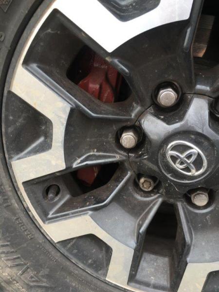

Hello, first time post for these forums. I've spent the last couple of days reading the wealth of information in this thread. I have not seen if anyone is running the sr tacoma wheels with the 231mm calipers.
Does anyone on here have experience with these wheels and the tundra brake upgrade without spacers?
Any input would be appreciated try to figure this out before I get new tires.

Any luck with the Gen 3 Tacoma Wheels?
Bump
Any luck? I was looking at a set too.
