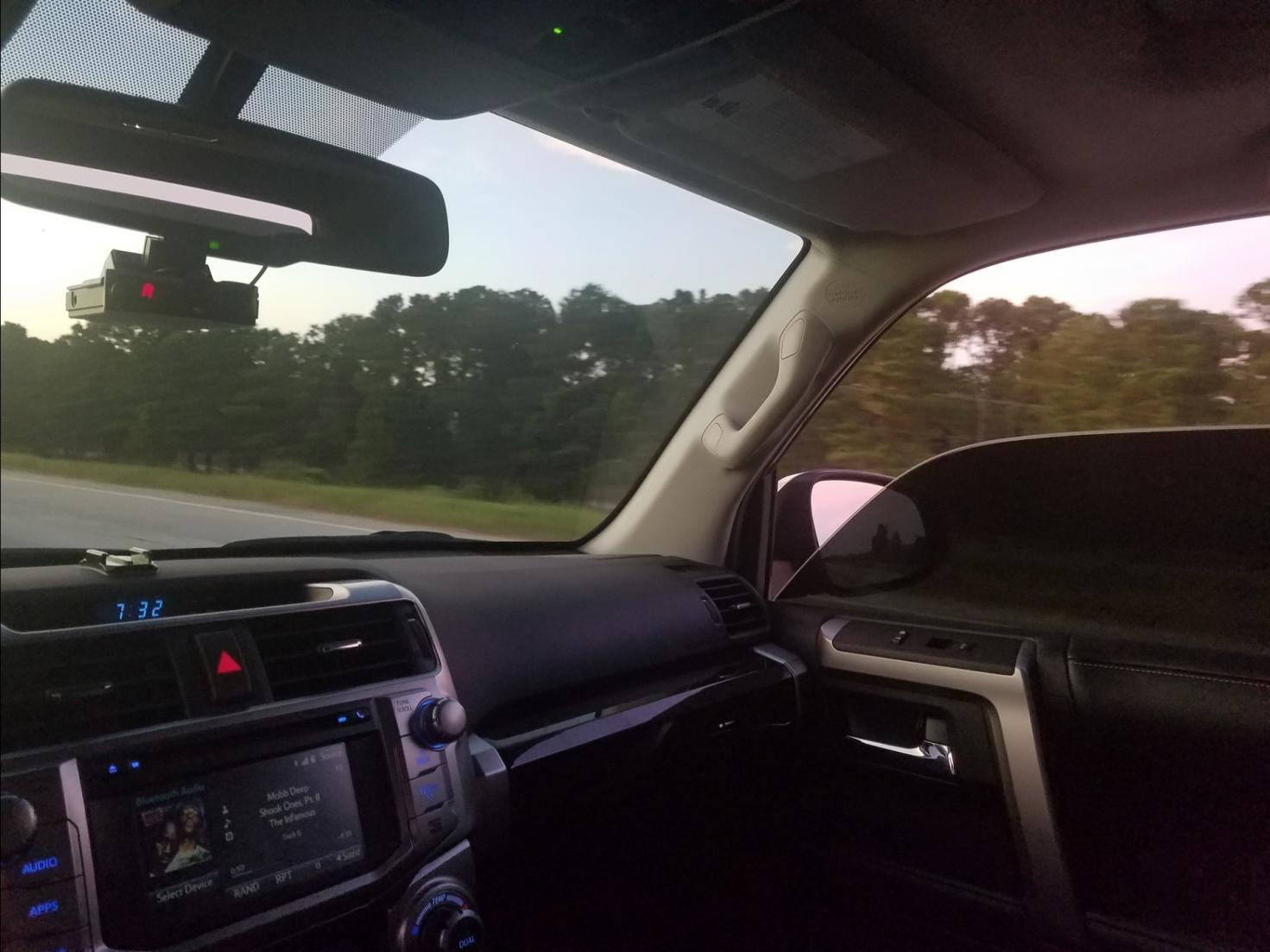

V1/BlendMount/MirrorTap.
Always on when I need it. Never find that it has fallen off the windshield because of suction cups, hot temps, etc. Love it.
