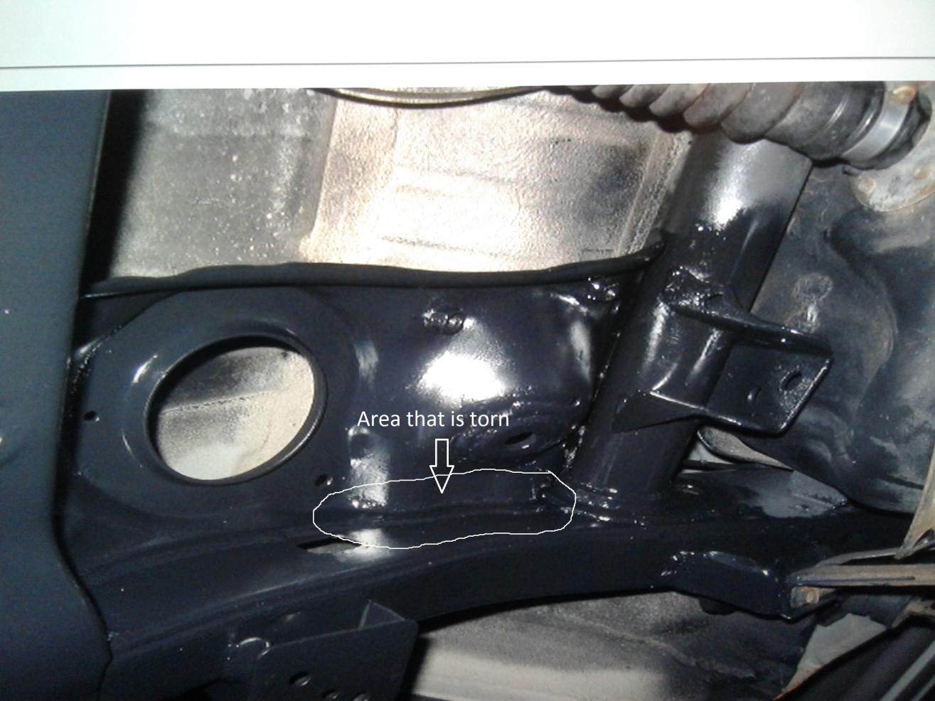

Has anyone experience this crack before?
nissanh
Senior Member

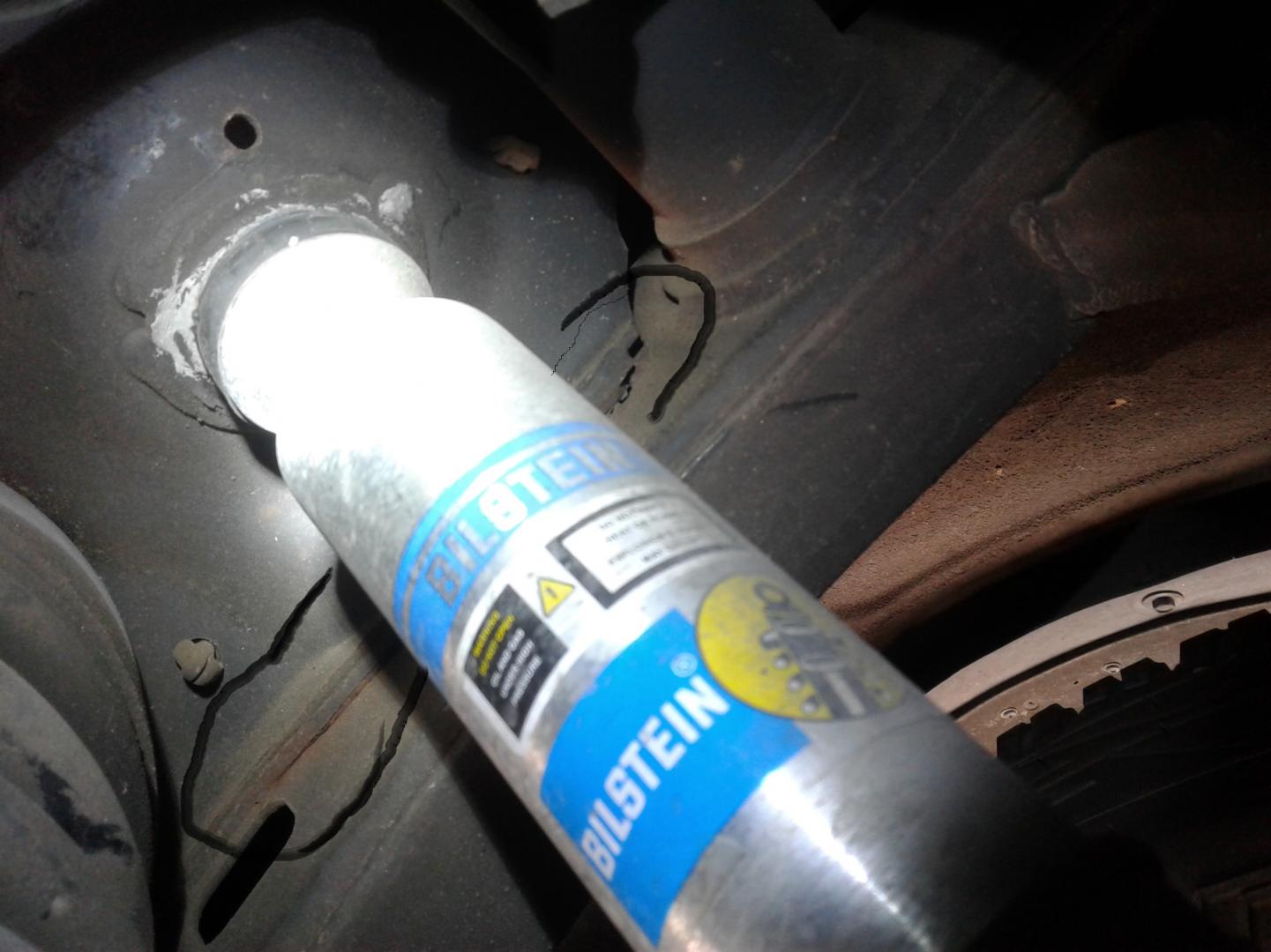

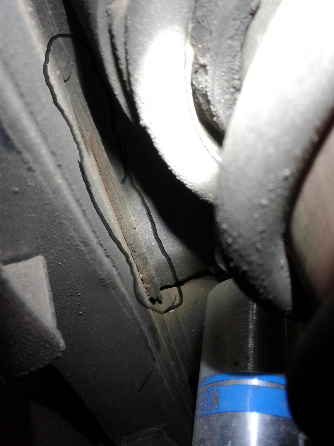

I saw this crack on rear left shock mounting plate.
The weld is intact however, the metal right below the weld is tearing apart. Must have been taking place for a long time.
Last Picture is from T4R member Scramble
Weld it? Any suggestions?
Thanks

I seen that area rotted out on a few of mine. Cracked so it has to be an extreme stress fracture that's going to need welded. You jump the 4 runner or do heavy off roading?
They are only welded on 3 sides with that crossmember tube weld being the weakest.
Sent from my SM-J337V using Tapatalk
Not at all!
The weld at the tubular cross member is also has come loose. Dropping the gas tank is not too bad but love to avoid if I can.

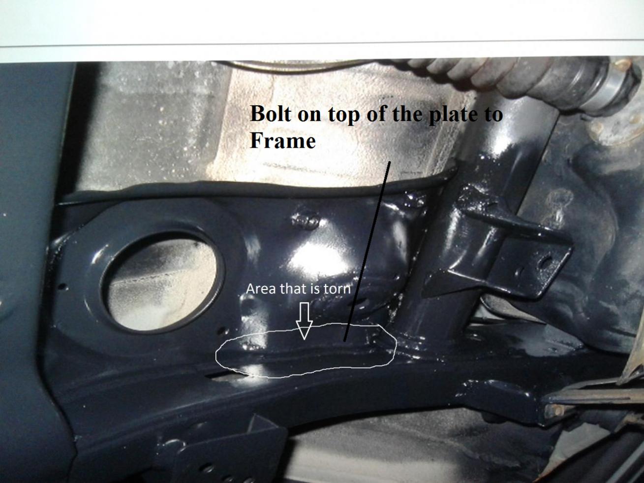

How about weld the torn and run two high tensile nuts and bolts from the tubular cross member to shock-mount plate as shown below to avoid the requirement to drop the tank to weld that area?

Maybe you added longer shocks but didn’t extend your bump stops?
If you do that then your shock bottoming out becomes the new bump stop.
good point
A very good point, but I installed these shocks about 2 years ago and never been off road for past 3 years. The 4R is used by my wife for past 3-4 years. It has air bags installed and I keep it at 7 psi. No issues to the passenger side.
Temporarily I put a ratchet strap to pull the plate towards the frame.
Could the Bilstein is too stiff? Those who installed this knows how pressurized these shock are.

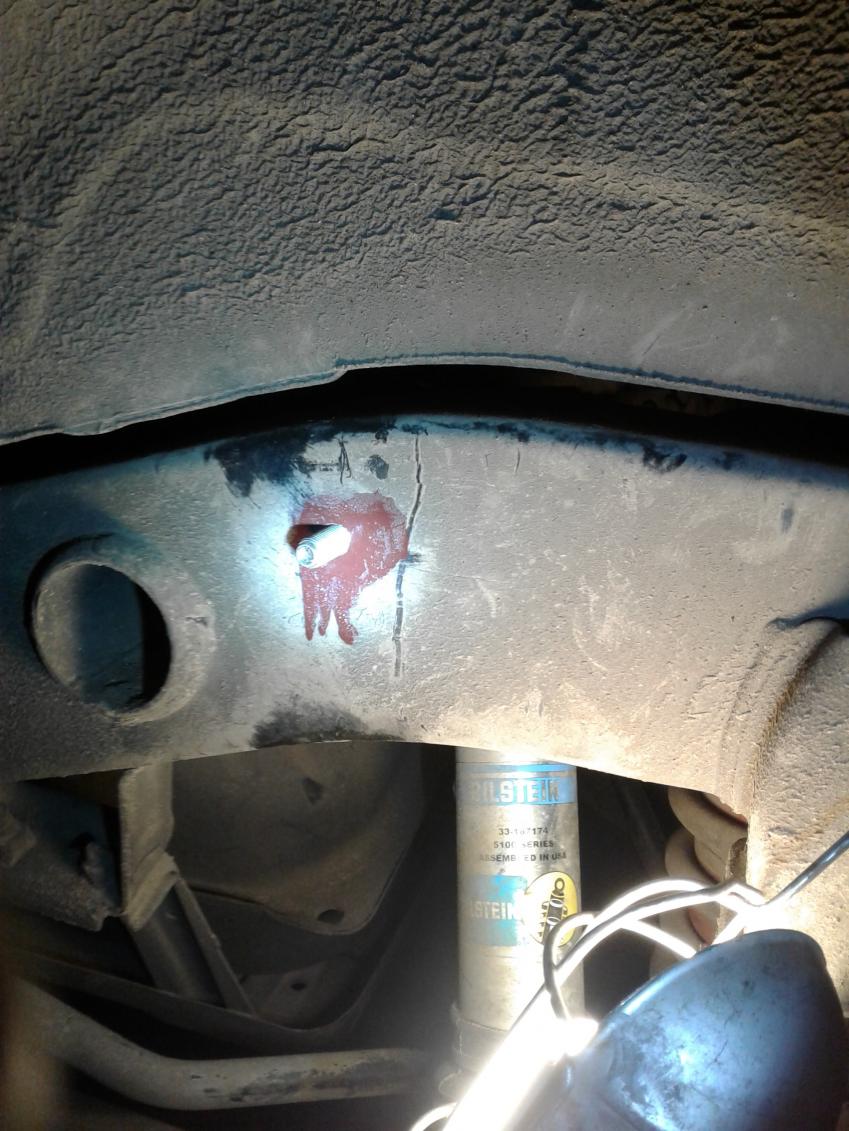

Just installed a 14 mm Bolt from the top of the plate where the crack originally started to the out side of the frame.

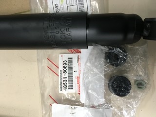

Can anyone confirm the Toyota 48531-80693 are Tokico's?
I might list the Bilsteins for sale soon.
Yes. They are. Have a brand new pair waiting under my desk.
Be warned, they don’t come with all the accessories like aftermarket do. Look at the parts diagram carefully. That little baggy is all that come with the shock.

So what's the consensus as to why this shock coil plate cracked and was tearing off the frame?
Most likely cause is bottoming out the rear shock absorber and acting as a bump stop (thanks "Dieselchessy").
