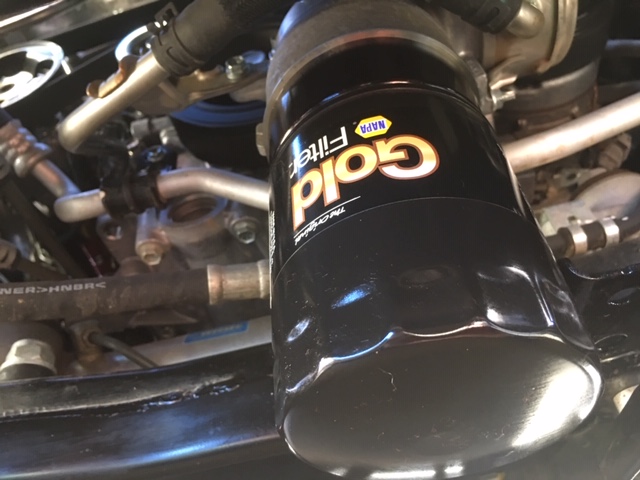

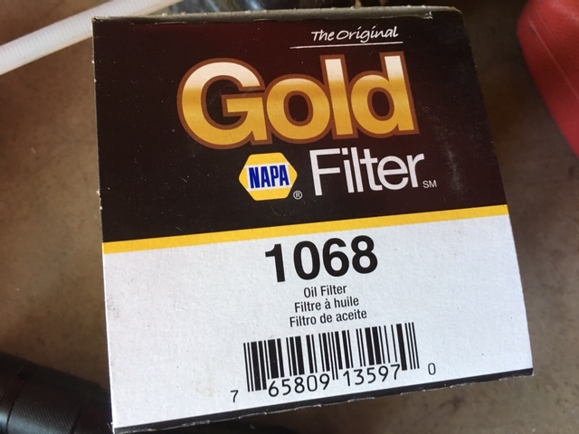

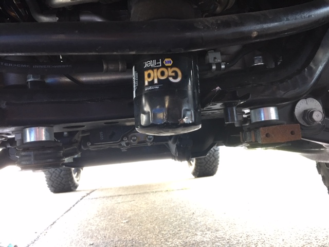

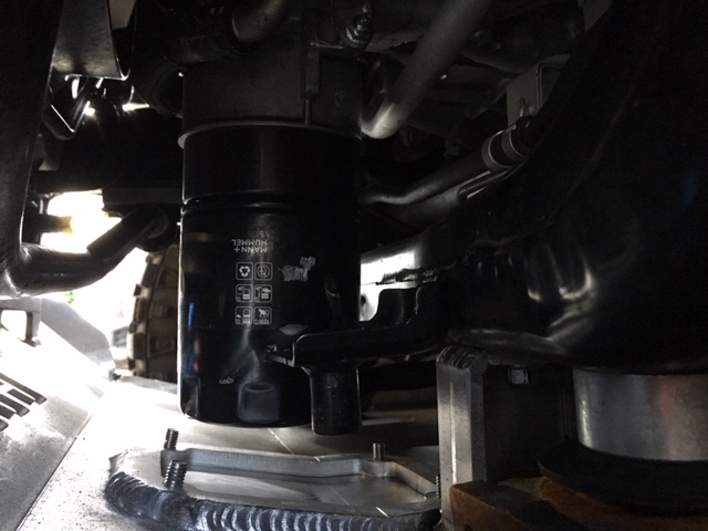

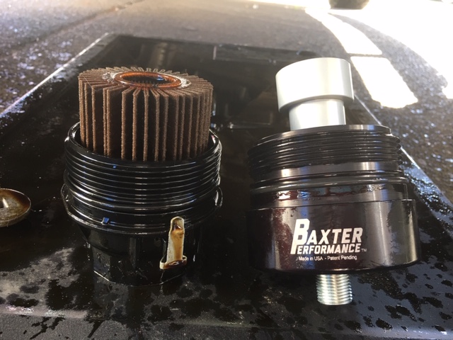

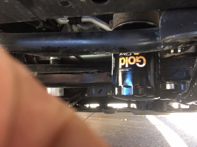

I used just the Baxter screw on adapter, took 30 seconds to install. Used a Napa Gold 1068 screw on filter.
One thing that has been debated with the remote setups is how much oil drains out of the filter when engine off allowing for more dry starts. I'm not sure if its an issue or not but figured I'd play it safe just using this adapter, still makes things quick and easy especially since the CBI skids have an access panel to the filter to change it
