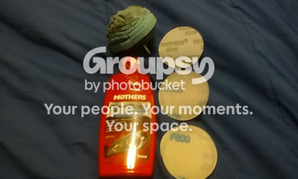

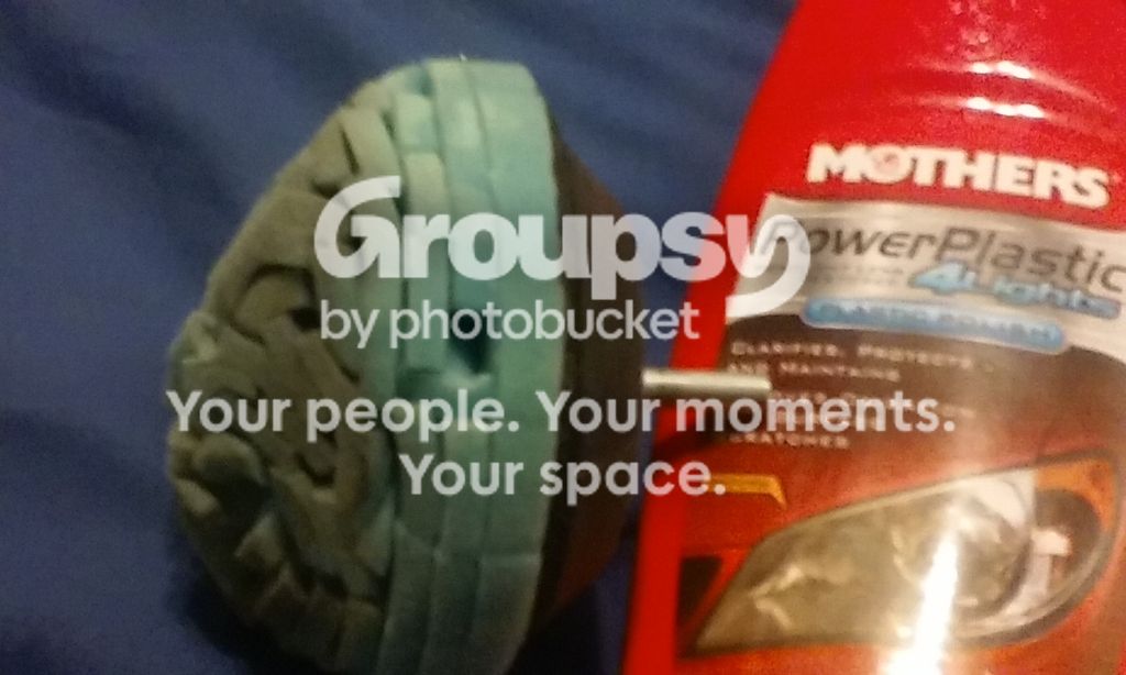

But it wasn't anywhere near bad enough to start grinding off the surface of the smooth plexglass at this point. But I had another idea. The last step of the Nulens product that I bought for my wife's car was a finishing polish; which does have a very fine abrasive cream in the polish, so I decided to give that a try.
I did exactly as I did with the Camery in the final stage. I first wiped the lense clean. Then I wet the lense using a spray bottle. I applied some polish, about the size of a quarter in the center of the sponge applicator and started to run the drill (slowly) moving the foam sponge from side-to-side, making sure not to touch the paint or anything else that I didn't intend to treat.
I didn't take any Before & after photos as I usually do in my write-ups because I had no plans to write this one up. To be honest, I really didn't think that this would work because I deliberately avoided using the emery cloth sheets as in the directions because my cloudy lenses weren't nearly tarnished enough to chance scuffing them up... but it did remove all evidence of that smoky film: "See below"
So if your prized 4Runner is starting to show signs of aging plexiglass lenses, this is the kit that'll work! As a matter of fact, perhaps you can just purchase the sponge applicator and the "MOTHER's Power plastic polish" on ebay or Amazon... I bought mine from Auto-zone for $19.95.

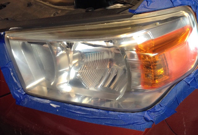

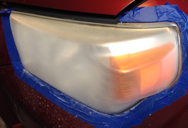

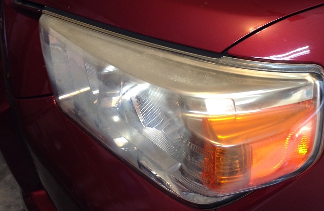

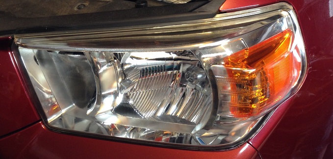

3M Kit 39084

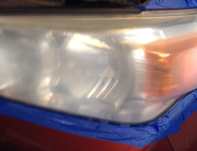

My 2010 4Runner headlights have yellowed and I suspect have never been restored so this would be the first time in nine years, and mostly parked outside.
I was going to try the Sylvania kit due to good reviews but Prime day deals turned my purchase to the 3m 39084 and 39173 kit.
The 39084 kit is hand sanding and polishing with no final coating, the 39173 kit has a final wipe on UV protection coating. Because of Prime day the two kits combined cost me about $15.
Being my first headlight restoration and a hand polishing kit on a nine year old lens, it took me about 4-5 hours to finish. I like the idea of a wipe on sealer which gave me easy control of the application.
I think I could have opted for a powered polishing kit but 3M will warn that it is easy to make a mistake if it gets away from you, experience prevails.
Obviously the real test is in the sealer and how long will it last. My time starts today and I plan on an update about a year from now.
Good luck with your project mine has turned out well.:D
