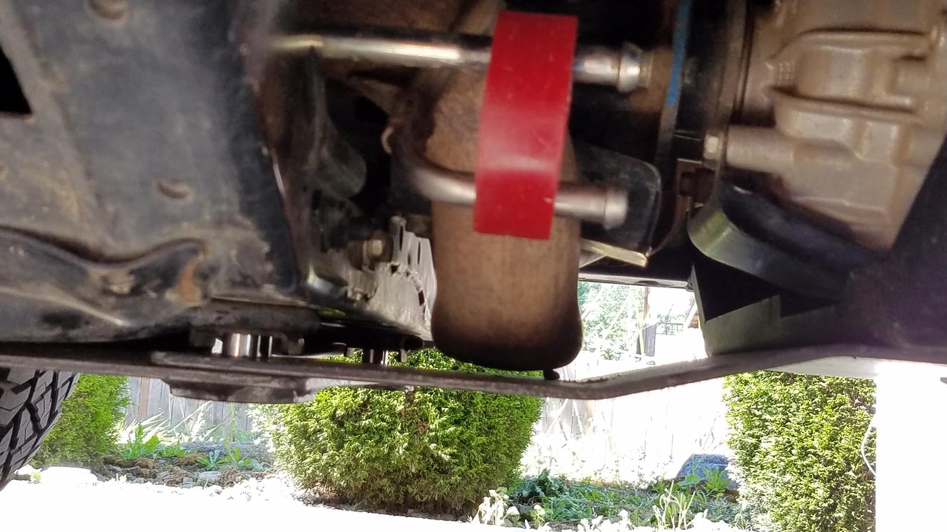

I did the worm clamp thing twice and after time spent on bumpy roads or trails it will fall off. I've lost two so maybe zip tie it so when it falls off you won't lose it. I also swapped out the OEM rubber mount with a Perrin 12mm poly mount part # ASM-EXT-100. Supposedly the material doesn't sag over time like OEM but after a couple of days it sagged and began contacting the skid plate again.
I used (4) 1/2" 5/16 SS spacers and (3) thick washers for the rear 7/16 carrier bolts. Not ideal as you lose a little ground clearance but if you want to get rid of the rattle/vibration you just gotta lower that skid plate OR re-route your pipe OR re-bend your skid to allow more clearance.
Here is a picture. Don't mind that little pebble stuck in there.
