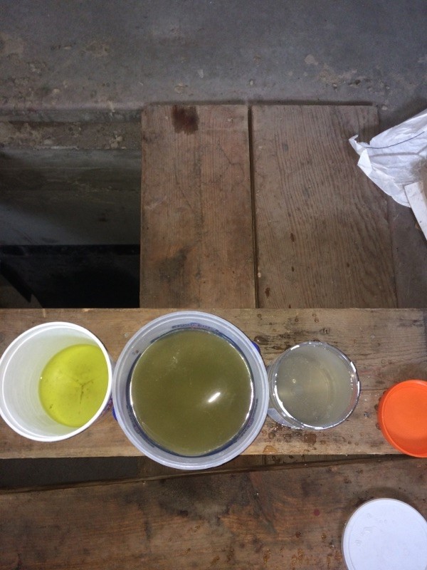

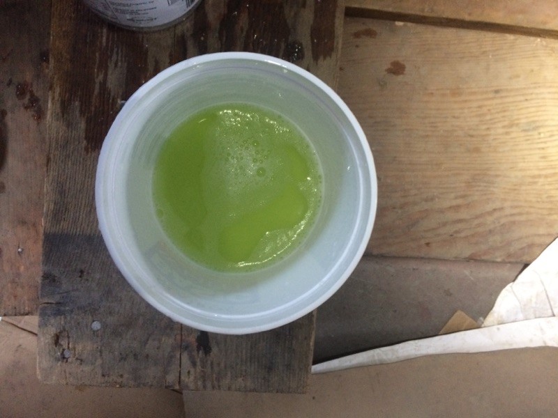

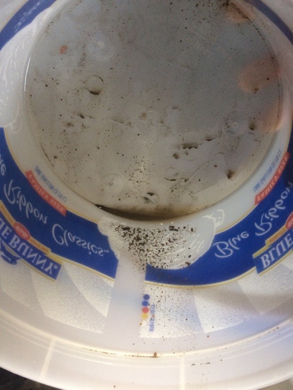

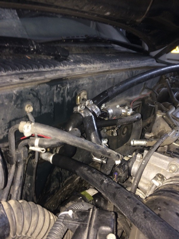

So I flushed my top heater core today and did not seem like I got much out of it. I just hooked up a garden hose to the inlet and outlet at the firewall. Used 10lb of compressed air to blow out the coolant (left container), then added a few quarts of water and blew it out (middle container) added in CLR let sit for 15min and blew it out (individual container). I just hooked the garden hose up and allowed low pressure to flush the system of CLR. CLR did absolutely nothing as far as remove any more material than the water did.
Temps are working great so far, but only took it on a few mile drive. I checked the temps at the valve, outlet pipe, vent, and defroster numerous times. Overall they were consistent with some slight fluctuations of a few degrees. Basically I ended up with the following temps at the vent and center defroster at idle/60mph.....125/145 and 105/115. The thing works great for now....will see if it keeps working so well.
